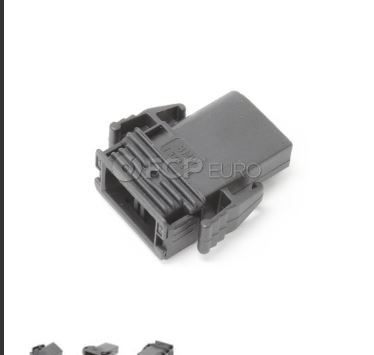

      I was lucky enough to find someone parting a 325 a couple hours away from me and picked up the AC system. It definitely helped me better understand how it all goes together.
      A couple follow up questions:
      -What are the part numbers for the wiring terminals for the female connector that gets spliced into the car harness for the new pressure switch? I searched and could only find the terminal and not the wires.

        Anyone? Looking for the part numbers for the terminals that clip into that connector in my above post?
        Thanks
            Thanks
            Well, almost 3 years too late but I'm going through an R134a conversion on my 86 325e and ran into the same problem. I called the dealership and got the pin part number. Unfortunately, it is currently unavailable so I will be splicing the old high pressure switch connector onto the new switch. For the sake of documentation though, below are the part numbers:
            Plastic Plug Terminal: 61131378400
            Snap-in Receptacle (2x per plug): 61130007441
            The snap in receptacle can be found in this diagram: https://www.realoem.com/bmw/enUS/sho...89#61130007441
            There is rubber molded around the connector/wire to allow it to make a watertight seal. You could probably make a connection work with another female plug from the diagram but it wouldn't be a watertight seal.
