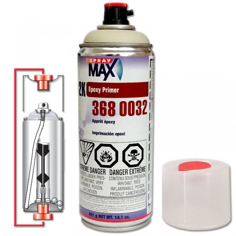

          they make rattle can epoxy primer as well. Great for spot priming. Once mixed, stays good about a week until cures in the can. There is a catalyst chamber inside, punctured from the bottom of the can and shaken well, epoxy primer ready to go Click image for larger version
