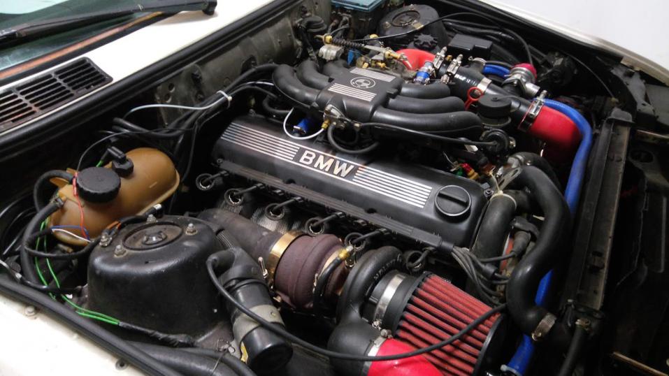

          • Mazdayasna
            • Aug 2017
            • 60
            Originally posted by efficient
            maybe just lengthen the hose and put it in the battery tray if you dont have a battery there.
            This is what I did. 1" heater hose from the parts store. I plan to do a late-model conversion eventually but this works in a pinch.
            I should have made standoffs to actually mount it to the battery tray, at present it is just sitting there. I normally have a heat shield mounted as well to protect it from heat from the downpipe.
