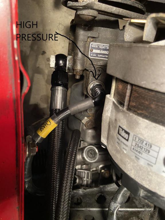

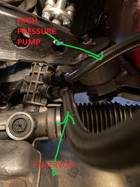

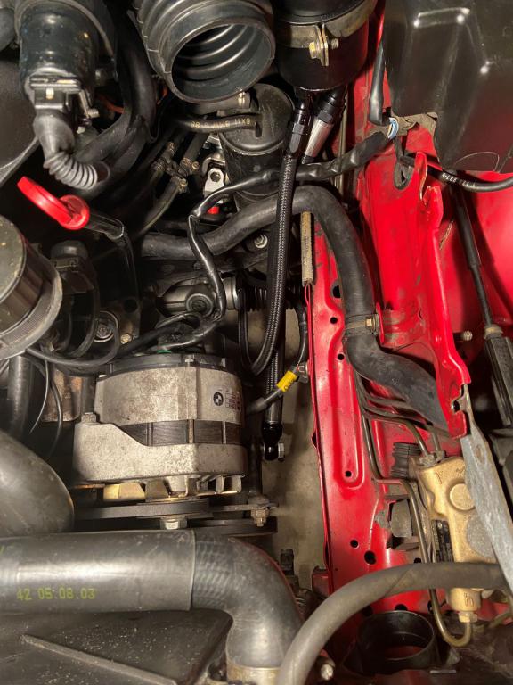

                Not really related to the original question of this thread, but would you be willing to post a picture of the Chase Bays reservoir and lines installed in your car? I recently bought this kit and am having a hard time getting the lines to line up with the rack and pump and cannot find anything online with a write-up or pictures of it installed in an e30.

                  Here are the photos...but please check my work as I'm having issues. Please let me know how yours turned out

                          It is actually possible to reverse the hoses at the rack with Chase Bays kit.
                          The two sizes are different however the way it works is; you thread in short adapters into the rack (the two different sizes) then you add the hoses to those adapters but these hoses have the same size threads.
                          I have the high pressure on the high side...should be correct. There's a video on line of someone reversing these two and it caused the wheel to turn violently when turning...so easy to tell if that's mixed up.
                          I have to find where the air is entering the system.
