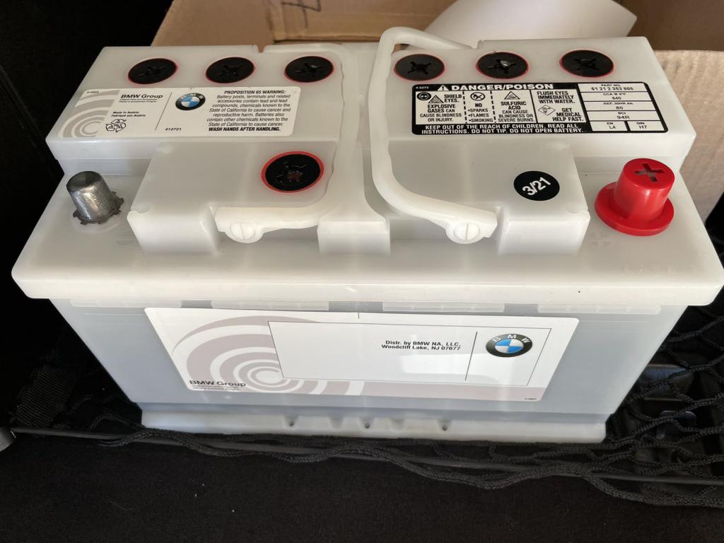

                    • z168
                      • 128
                      got this over the weekend. the dealer couldnt match it by part number so we physically compared the ratings and I ended up with this
