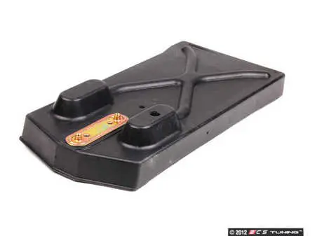

              Here are pictures of the metal plate I was trying to describe. It is sandwiched between the plastic tray and support bracket. It's what the battery hold down rod screws into. I'm guessing it's not available from BMW.
              battery hold 3 by cory58f5, on Flickr
              battery hold down 2 by cory58f5, on Flickr
              battery hold down 1 by cory58f5, on Flickr
              Thanks, Cory

                • Vincenze
                  • Apr 2019
                  • 1044
                  The plate is available from BMW as part of the plastic battery tray.
                  https://www.ecstuning.com/b-genuine-...y/51711953889/
                  Look for partouts and ask about the plastic tray, and the cable too.
