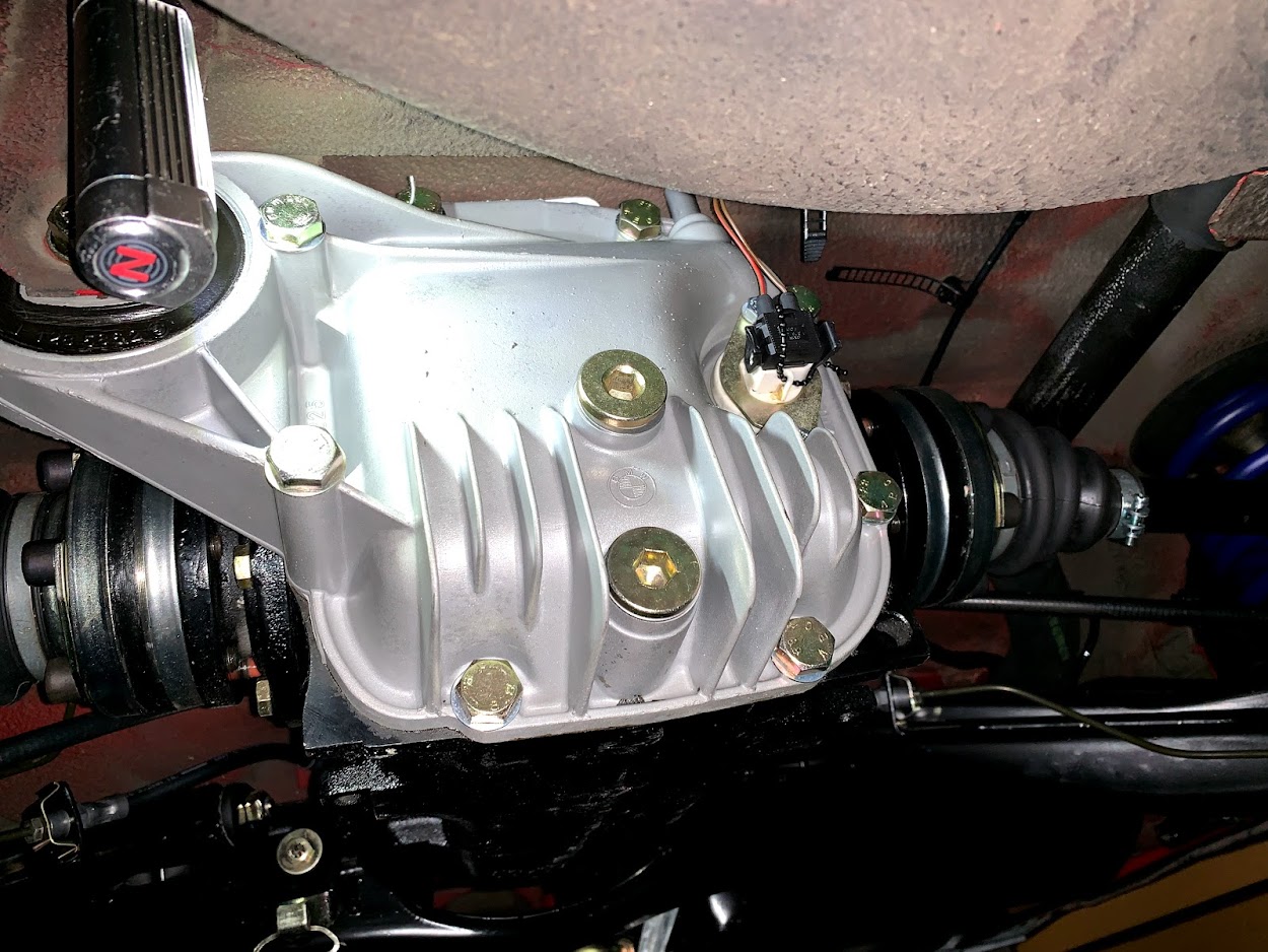

      MTL for Trans
      MT-90 for Diff
      Speaking of the diff. This took a while, but I was able to find a reasonable match for the cable tie that keeps on the speedo sensor. Turnsout the best fit is a tamper-resistant seal that is used for cargo shipments. The things you learn doing this stuff...

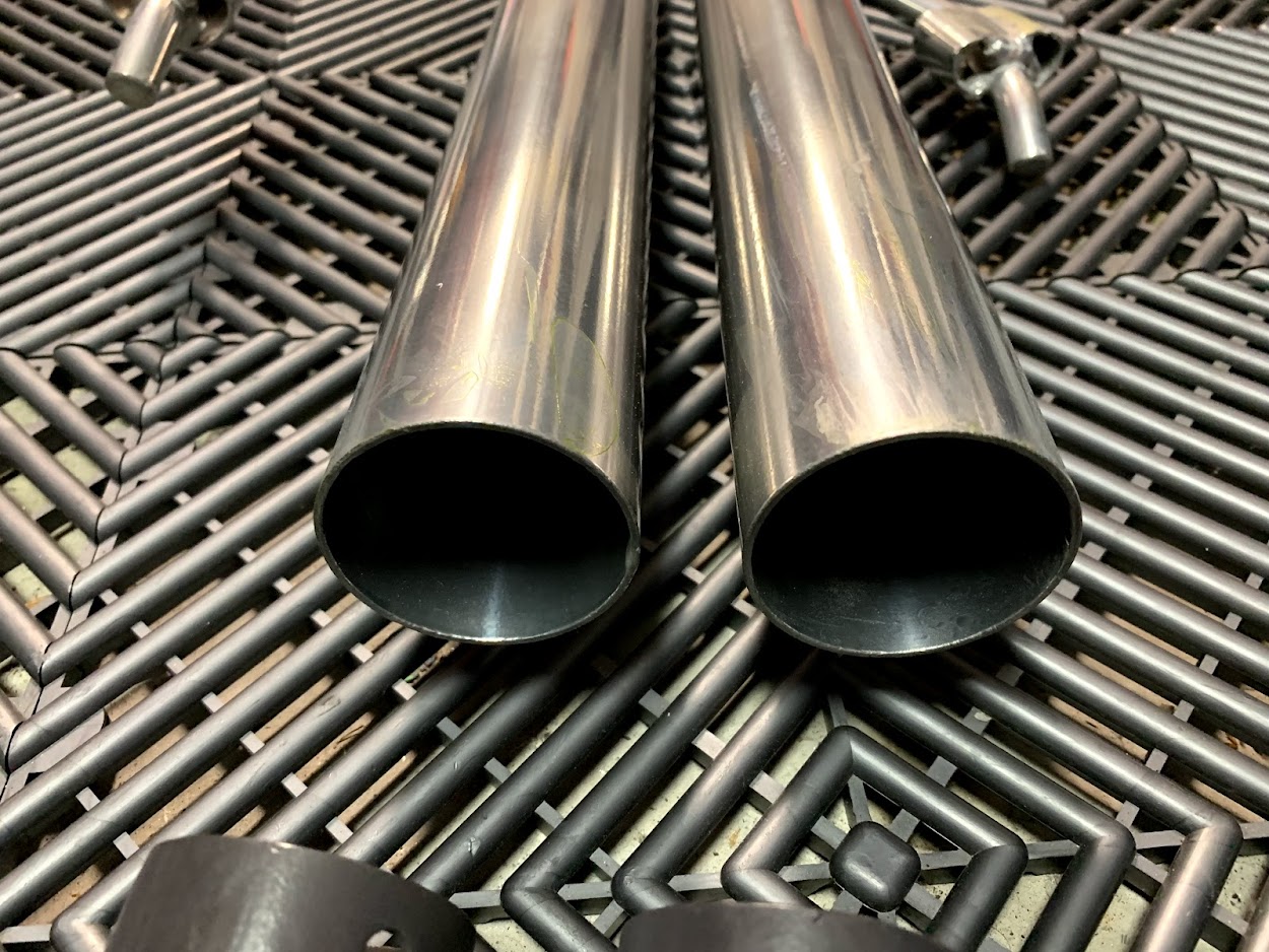

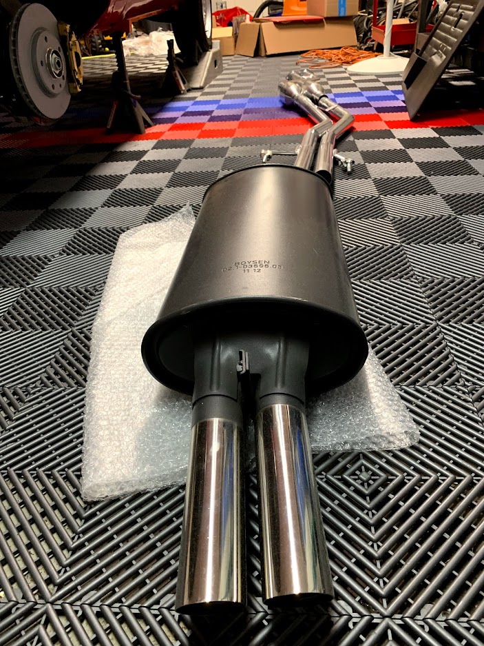

      Exhaust. I looked through my old exhaust and determined that it is too roached out (tech term) to bother restoring. Whoever welded on this thing must not have had opposable thumbs. Anyone else spot the stick weld element still attached in one of the pics below?
      So here's the replacement.
      VSR high flow cat factory style stainless steel, dual 2" with ceramic exterior coating
      BMW OEM EVO III Muffler
      Those little rocks are from the pre-coating tumbling process. I got them out after this pic. May have the flange to pipe transition welded smooth.

            Header is factory, ceramic coated (Calico Coatings) inside and out
            Mid Section is VSR, stainless, ceramic coated by VSR outside only (inside would mess with cats)
            Muffler is OEM (Evo III) no coatings

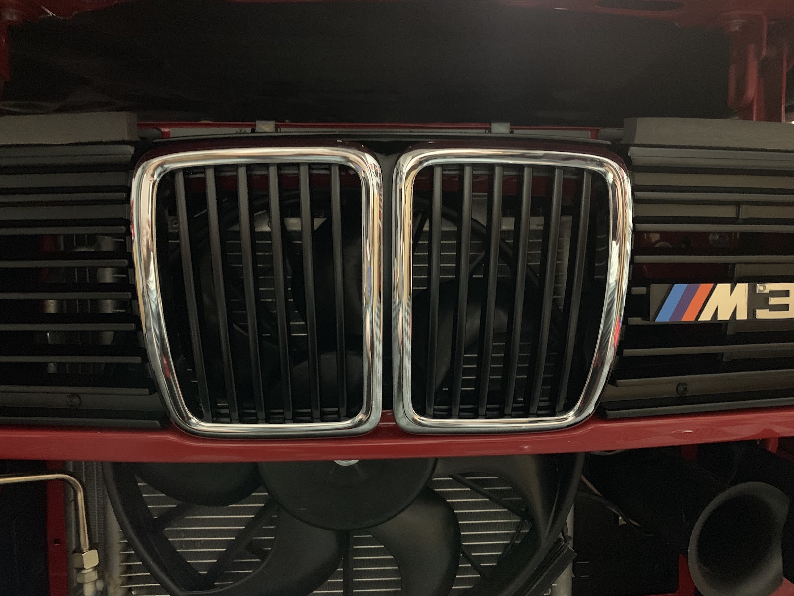

                    Euro Grille (R) with AC sticker
                    Euro Grille (L)
                    From font (Condensor fan on now)

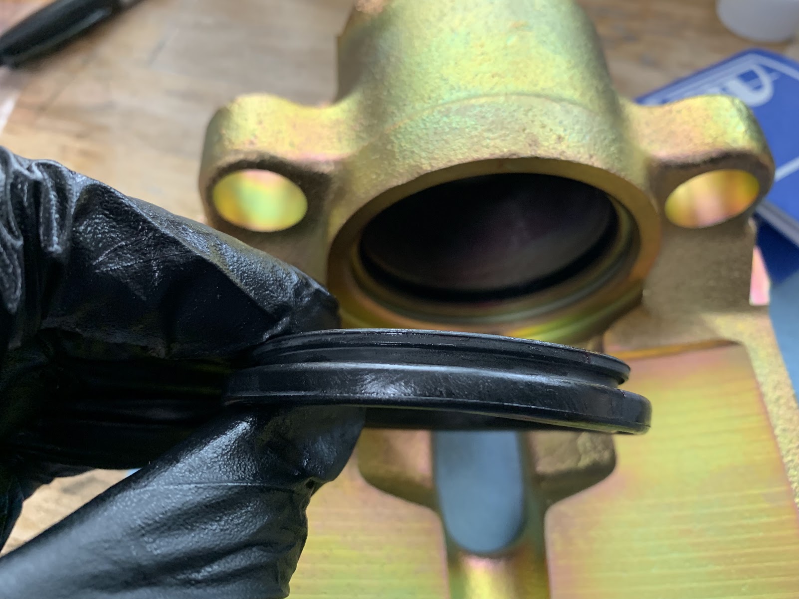

                    These things came out GREAT. I used Korman to do the plating, they glass peened them and had their plater run them through several times. I cant imagine them looking better coming from the factory - these things are like jewelry.
                    on and torqued and marked
                    Rear Caliper
                    Caliper boot kits
                    This is the grease Korman suggested. I think Russian beluga caviar is cheaper per oz.
                    Inner seal in. I've read stories of some people receiving these with a chisel shape profile instead of a rectangle profile. THis wasnt the case with mine, both sides were flat on all four caliper seals. Coated with the super expensive grease and installed.
                    Easiest way to put the dust boots on is to grease them, install them on the caliper first, then press them into the caliper (gently, i had to rock them back and forth very slightly to align them, and then they went in with minmal resistance). From there it was easy to work the outer edges around the caliper lip. The rears have a retaining ring, the fronts do not.
