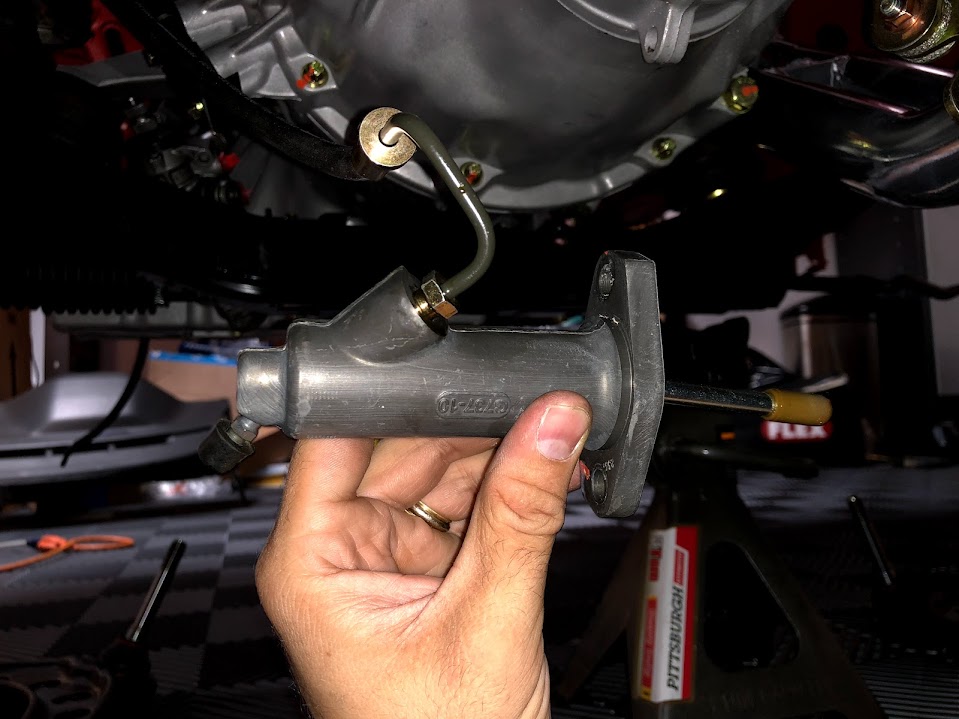

                    Slave cylinder hooked up

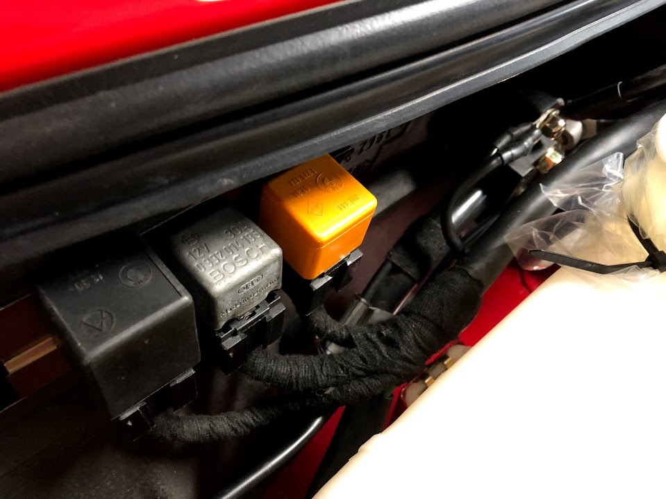

                    Relays in place

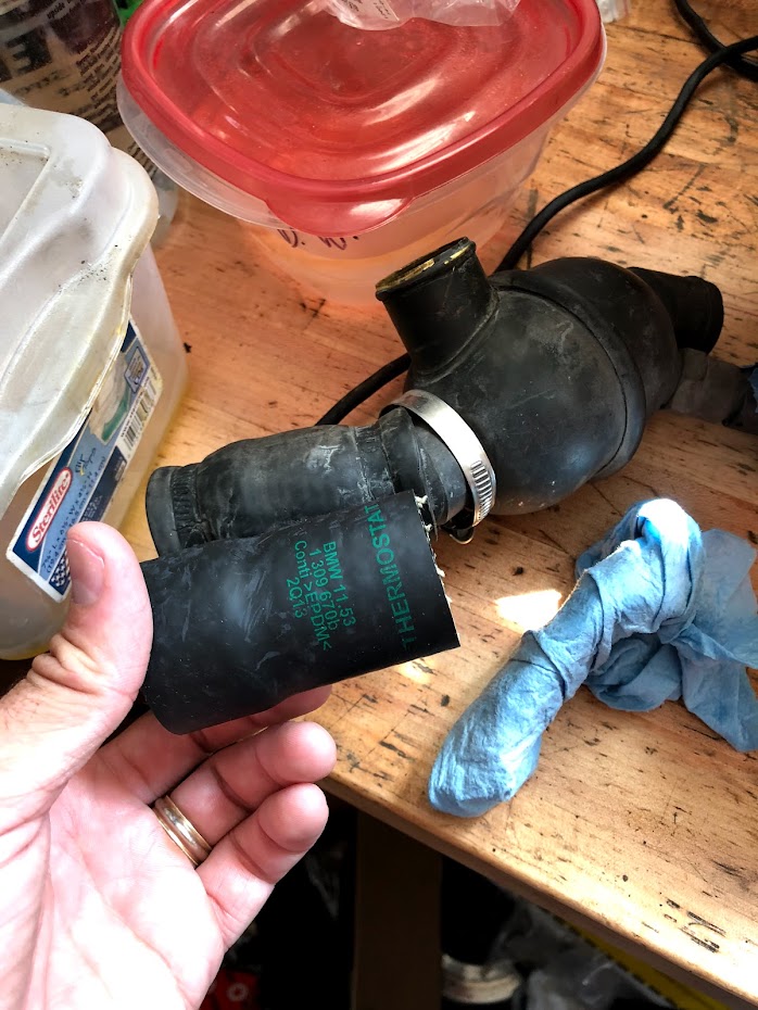

                    Coolant line (feeds into heater core). I elected to not do the diverter valve retrofit because 1) it makes the back of the engine bay hose routing a mess, 2) I’ll hardly ever be using the heater
                    Hoses in place
                    You can see the one that runs down to the engine block and goes into the top part of the heater core. The one with the blue stripe runs out of the bottom and goes to the coolant rail which leads to the thermostat.
