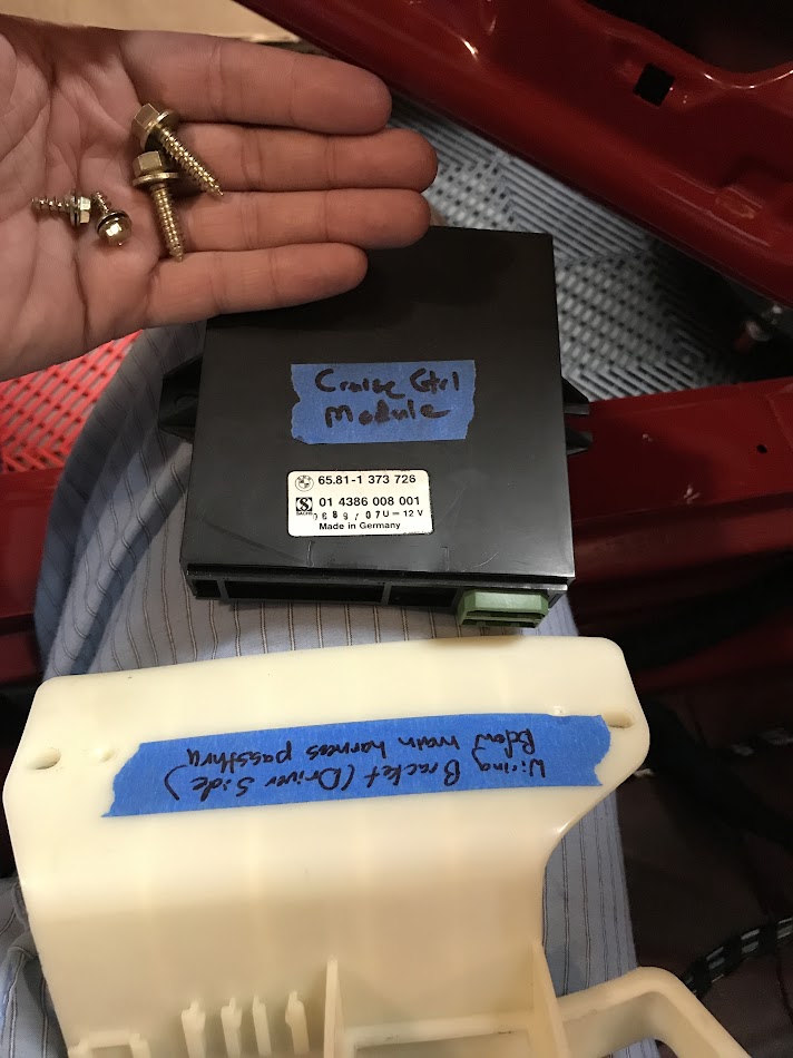

      Wiring Install.
      You saw the wiring removal and labeling. I was somewhat surprised that the reinstall was MUCH easier than the removal. This was because I took a lot of pictures, was very careful with labeling, and significantly improved the tape wrap coverage vs before when the tape was disintegrated and dry rotted.

      Driver footwell relays
      Taking time to get the harness secured and neat. Wont be complete until I put the dash back in, but this is still a huge improvement over the scattered mess i had when i started.

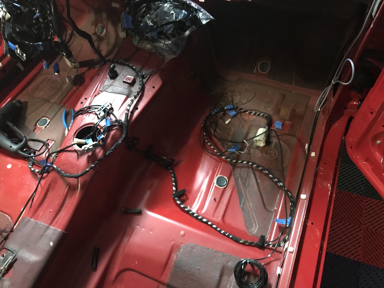

      Back to the floor, passenger side.
      and from the driver's side

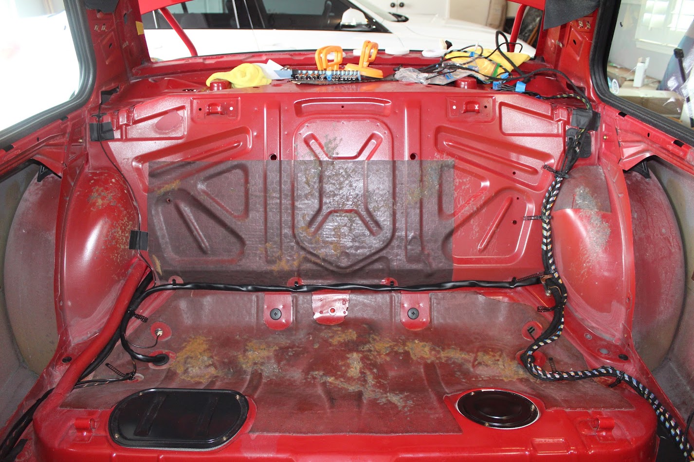

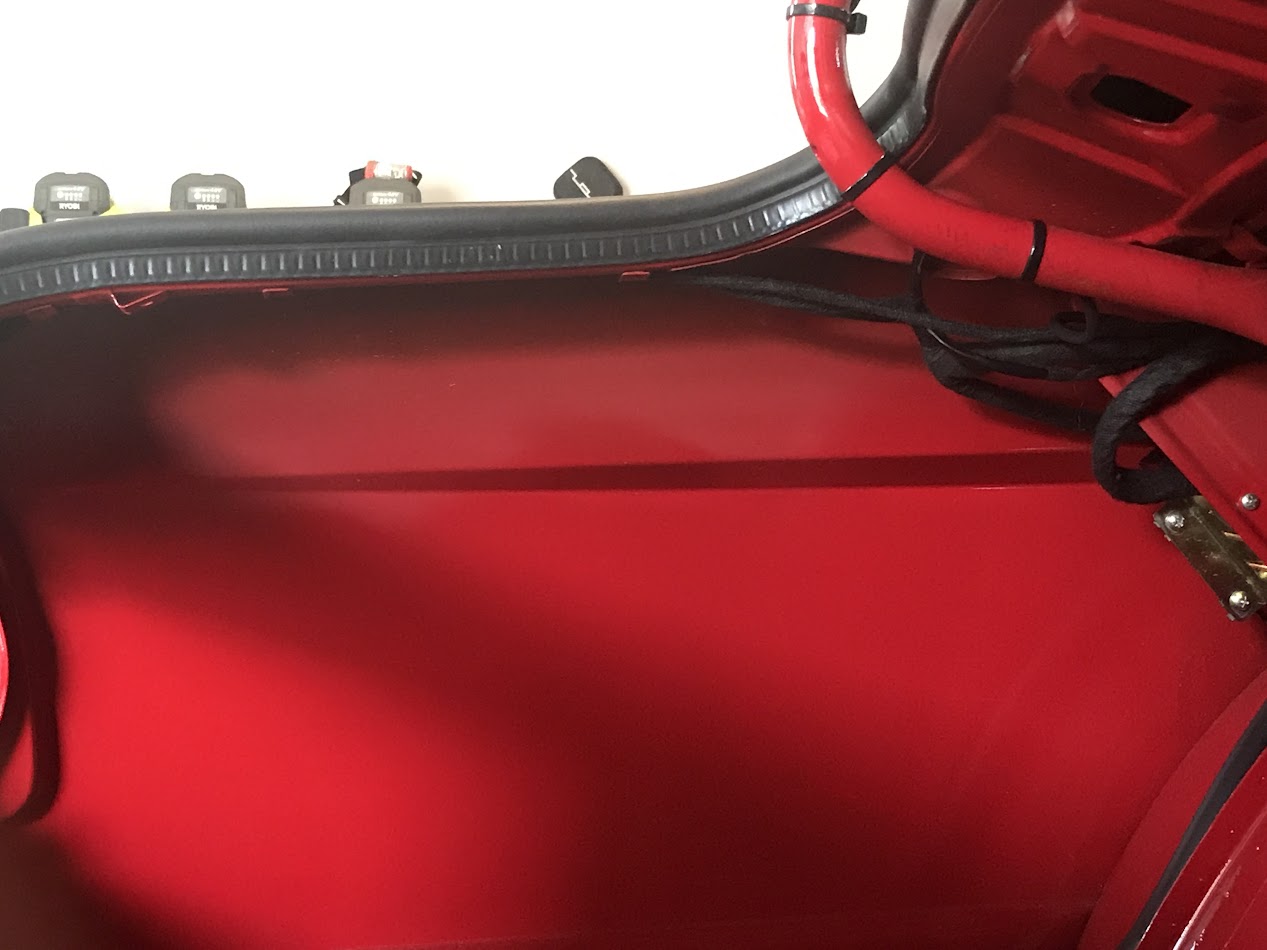

            Trunk time
            no metal on metal please - cut a foam gasket to go around the edge
            Wires wires wires wires
