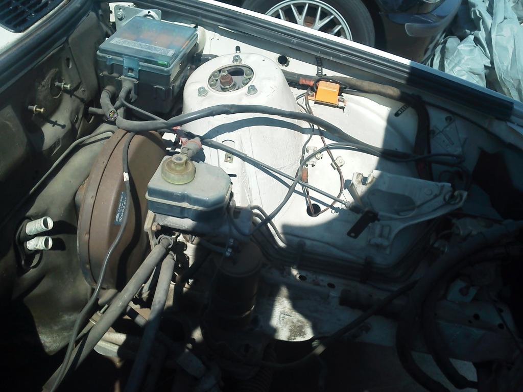

          A few more pics.

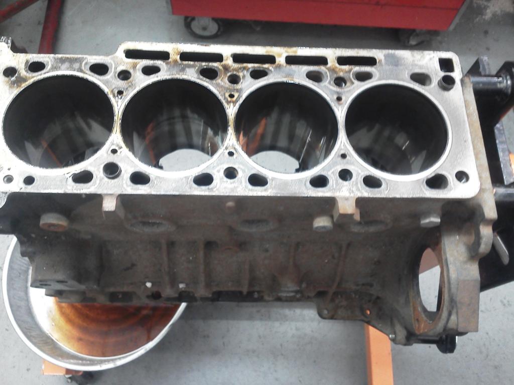

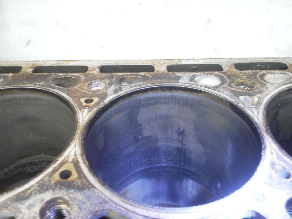

          I managed to find time to take apart most of the motor.
          Looks like new pistons are on the menu. Cylinder walls are slightly scored. TIS allows for .006 piston to cyl. clearance. these measured at .004. Not enough meat to hone it out.

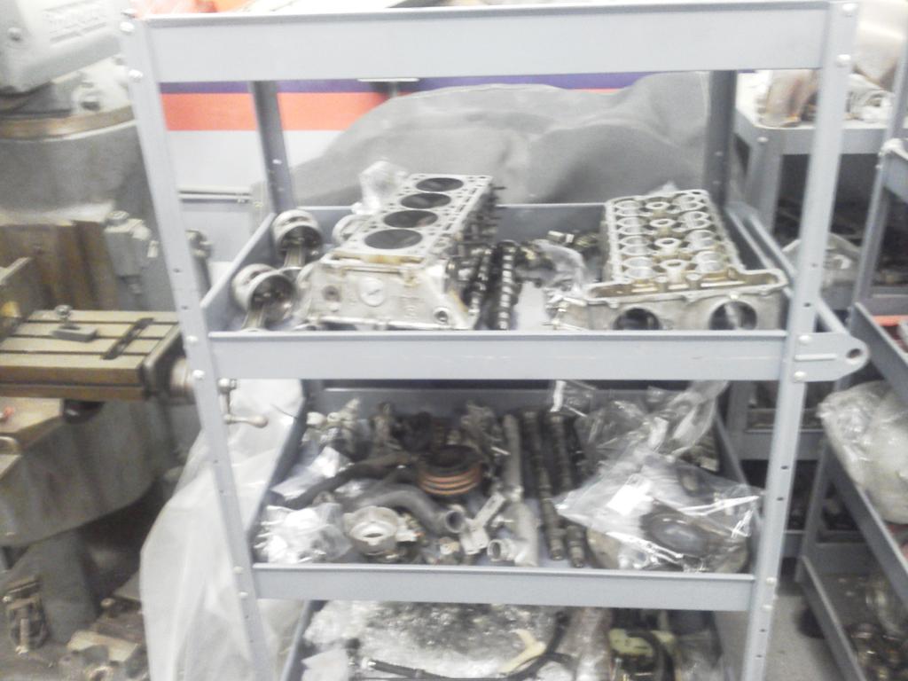

            Next up is the head, and checking the valves for play. Hope I don't have to replace the guides.

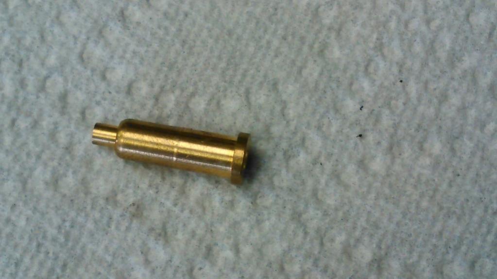

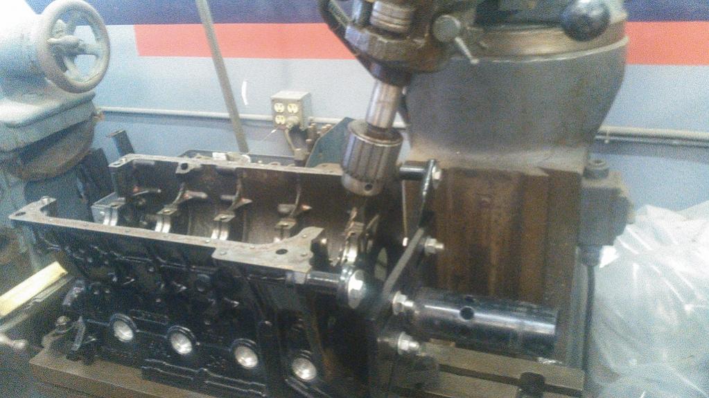

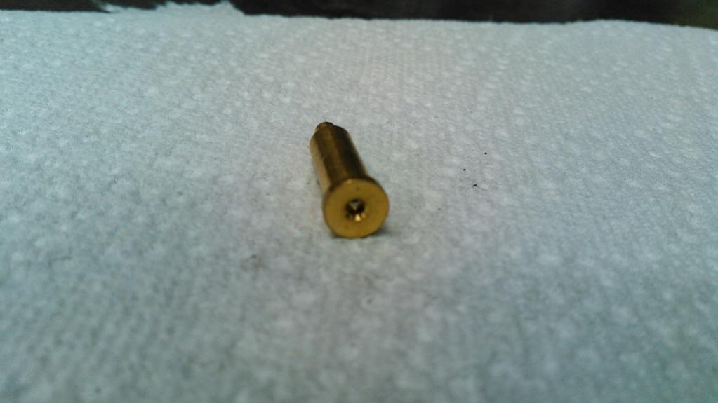

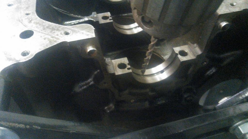

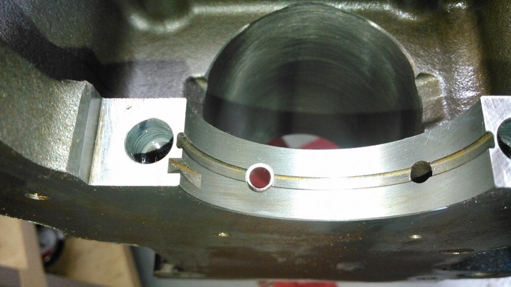

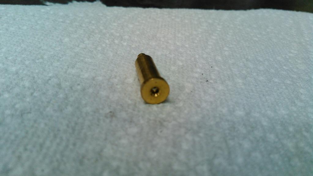

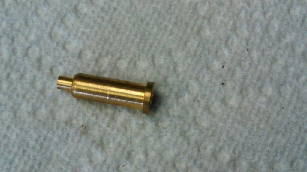

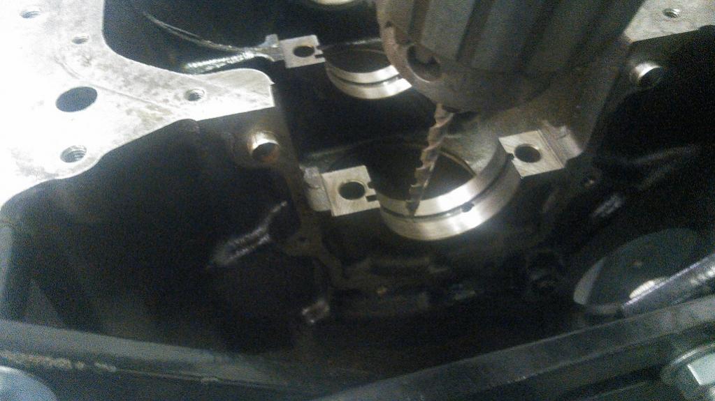

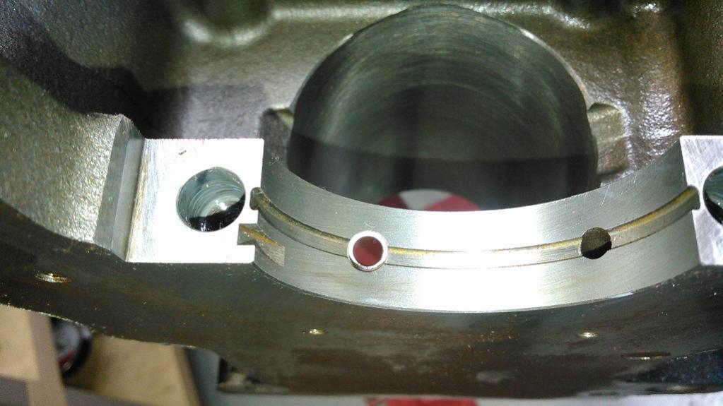

                  This week I worked on the block. I cleaned it up and painted it. I like doing this before machining so I don't have to tape off the machined areas later.
                  After long pondering, I've decided to add piston oil squirters. I'm using the ones from an e36 m50 based engine. I prefer these because they have a built in check valve to maintain oil pressure during idle. There's also a lot less machining involved too.
                  This photo is of an S52 showing the factory drilled hole.
