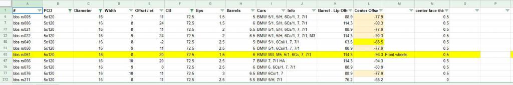

    First of all, here's a screenshot of all the BMW 5-lug, 16" wheels based on a table I found:
Name:	bbs wheels.JPG

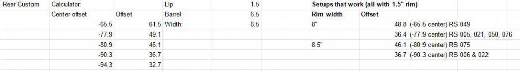

    I used this table to look to see what different center plate offsets are available. It looks like there are 5 (or possibly 6?, see the BBS RS211) center face offsets. If I combine those center face offsets with available lips and barrels, I come up with four "viable" rear wheels: 1.5" lip on all options, with either a 6 or 6.5" barrel:
Name:	custom rear bbs wheels.JPG
    So the question is this: does anyone have any experience with the 4 options "Setups that work"? I think the 8" wide wheel with an offset of 36.4 would be the "easiest" one to build: It would only require me to get a full set of 4 of the BBS RS061, and then swap out the face plate of the rear wheels with a faceplate from a variety of BBS wheels: RS 005, 021, 050, or 076.
    The other option is that I'll need an ET40+ offset, but those face plates that create that offset appear to be more rare, and then I might need to run a spacer.
    Any experience with doing this rear wheel setup? Any further input on the front wheel setup with the e36 M3 brakes?

      Copying the screenshot above to searchable text: Can anyone confirm these numbers look correct, and confirm which setup works with the Z3M rear trailing arms and hubs?
      There appear to be four viable options:
      1.5" lip, 6" barrel = 8" wheel:
      Center face from a RS 049 = offset of 48.8
      Center face from an RS 005, 021, 050, or 076 = offset of 36.4
      1.5" lip, 6.5" barrel = 8.5" wheel:
      Center face from a RS 075 = offset of 46.1
      Center face from an RS 006 or 022 = offset of 36.7
      Thanks!
