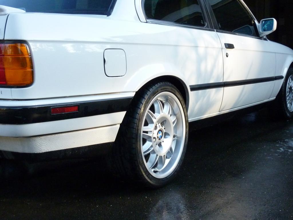

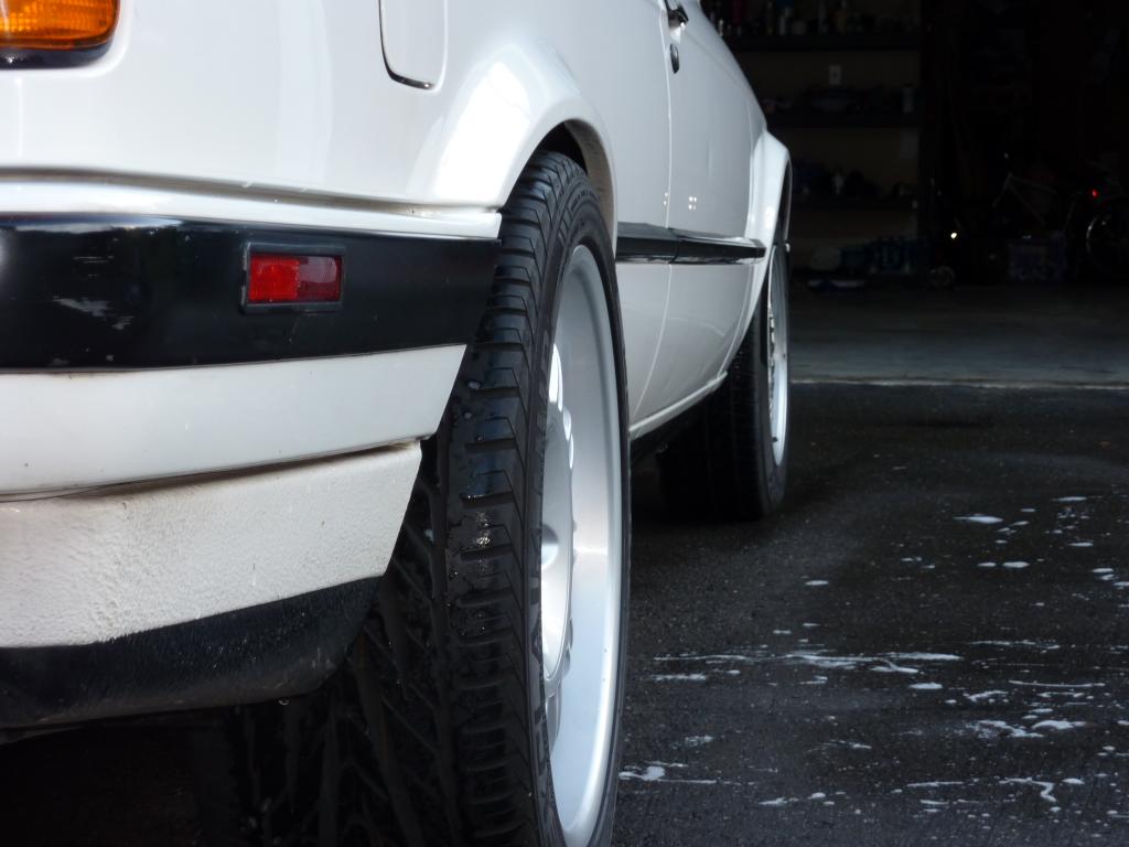

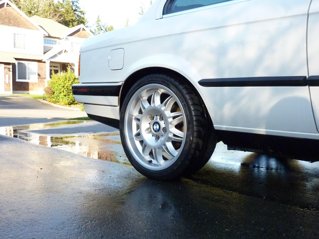

                  • hoveringuy
                    • Dec 2005
                    • 2747
                    Originally posted by turbo325i
                    We need pics of those ds2's NOW!!!
                    This is with the 7 1/2" rim w/ 215/40 17s.
                    With 8 1/2" rim and 245s...
                    • rkettner
                      • Jun 2007
                      • 367
                      i like the 7.5" look. this is the reason we talk about 5 lug swaps!
