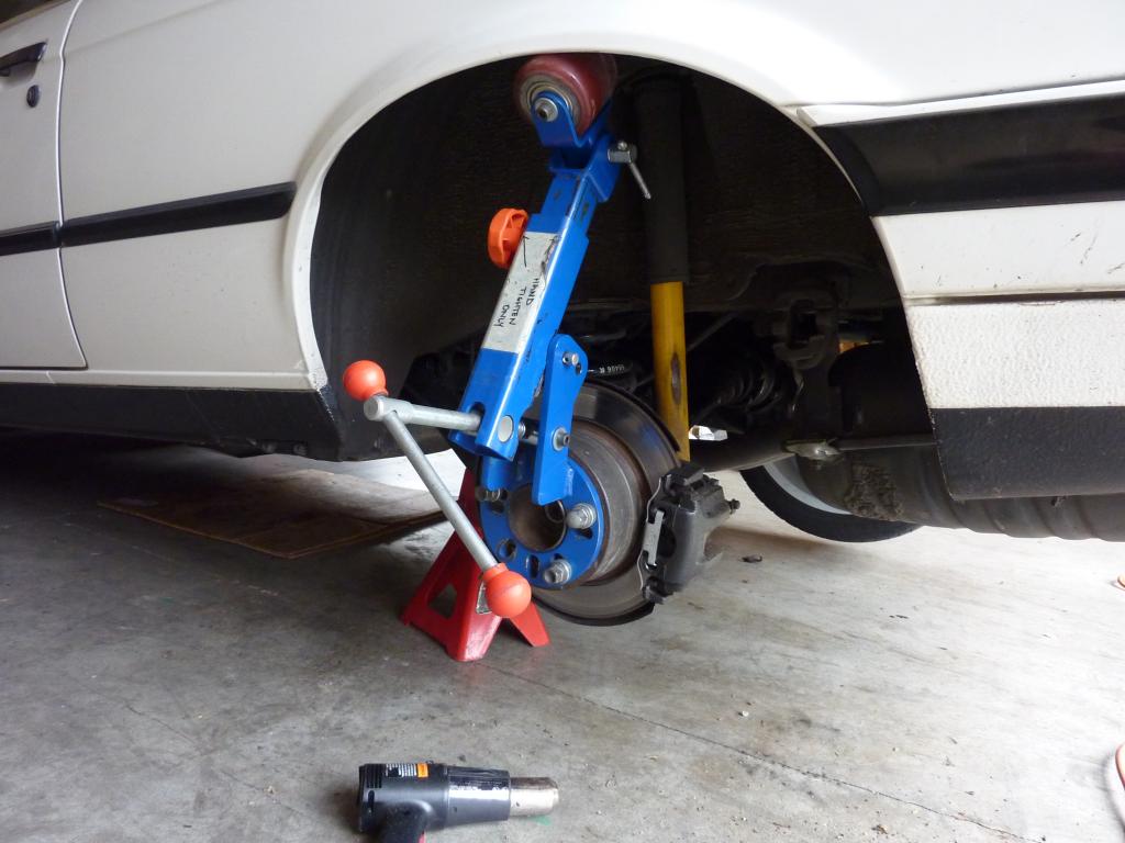

    Rolling the fender... even with plenty of heat I still had some cracking on both sides and it even flaked off on one side. I still have a touch of rubbing on both sides under hard acceleration with corninering + bumps.
    Eventually I'll swap the 245/40's out for 245/35's to make Daniel happy and get some more clearance. It's at about -1.2 degrees camber now and a touch more might help, as well.

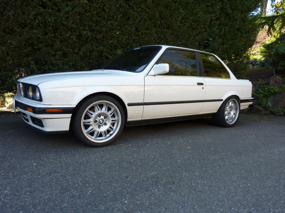

        Fronts are done. Took about 2 hours per corner including swapping CABs, springs, etc off the old struts.
        Pretty straightforward, some of the balljoints needed a good whack to free them.
        The biggest issue was that on re-assembly I left the tie rods where they were for the e30 suspension, it made the wheels toe out horribly and the car looked pigeon-toed.
        I lived in DC for 2 years so the tie rods just wouldn't losen and adjust until I freed them with the smoke wrench.
        Yes, I'm addicted to Oxy.
        I ended up needing to cut 1/2" off the collar to screw the tie rod end in far enough to square the wheels.
        Lesson learned: have new tie rods ready for your swap, you'll be adjusting them massively.
        ABS was connected and op checks Ok.
        Driving impressions: On the original suspension/brakes, I had a hard time locking up the 195/14s. The brakes were adequate for a Corolla. ABS only ever came on in the wet.
        With the M3 brakes.. holly shit!... the car stops hard. ABS comes on over dry pavement if I nail it semi-hard. Brakes feel very nice. Not extremley hard, not mushy. 25mm master is perfect.
        Initial measurement is about -2/3 degree camber on each side.
        Wheels are perfectly centered.
        Cornering is better but I haven't explored hard cornering... yet.

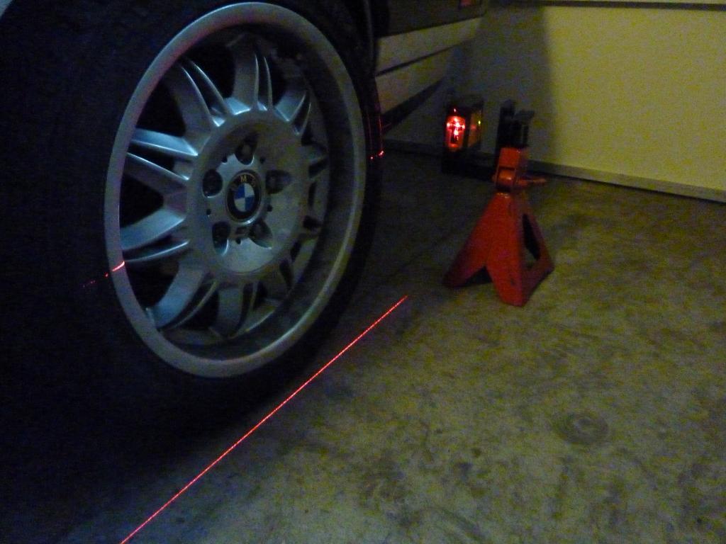

                I found that my self-leveling laser works killer for checking/adjusting the alignment.
                Now, what specs should I be setting it to?
                • Aptyp
                  • 6584
                  #38
                  nice use of laser there, stop by any tire store and ask for specs.
                  • hoveringuy
                    • Dec 2005
                    • 2747
                    #39
                    Thanks, eventually I'll take it in for a "real" alignment. For now I'm at 1 degree camber in the rear with .3 total toe-in. 0 toe in the front with 1.3 camber, soon to be slightly over 2.
                    I've also removed the rear brake bias valve.
                    Impressions so far is that in "normal" day-to-day braking and hard wet braking it doesn't make a difference.
                    In aggressive dry braking when the tires are warm and grip is good, I can feel more bite before the fronts start to lock. The rear gets more involved.
                    I'll leave it as-is for a while, the next step would be for me to change pad compounds, I think.
