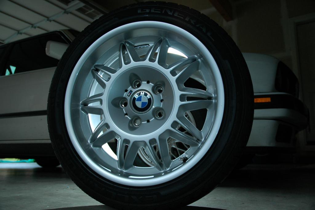

    So I finally found the DS2's I've always wanted. They were garage queens that are effectively new. They're staggered and are wearing 225/45-17 in the front and 245/40-17 in the rear.
    I think the 245's are too wide. Should I trade the rears for a set of front rims and build a square set, or just get smaller tires for the rear. What size?

              Or run 215/40 front and 245/35 rear.

                  So, 235/40's will work in the rear as will 245/35's. How tight are 245/40's? Who has 'em? How much fender rolling? Can I just run and extra spring pad under my H&R sport springs and call it good?

                          If I were to run staggered I'd go with 215/40/17 front and 235/40/17 rear or possibly 245/35 rear.

                            That's exactly what I have for my fronts now. In fact, the guy came to buy the old 224/45's about 10 minutes ago. The diameter is maybe 1/4" taller than my 195/60-14 tires.
                            Rear will be 245/40... for now. My plan will be to swap the rear first with the 215/40's so I can see how the 245's fit and either roll the fenders and/or purchase different tires.
                            Once I have the rear sorted I'll swap the front.
