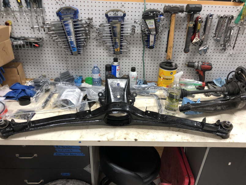

          Here's a thought I had while looking at my rear subframe today.
          Would alignment affect or contribute to wheel hop?
          My car is within factory specs and rear alignment is not adjustable as stock. It is mildly lowered in the rear, but it's not "slammed".
          I have not considered adjusters as I've heard of them losing position over time, in addition to finding a shop willing to play with aftermarket alignment bits.
          I will think about welding in adjusters if you guys think wheel hop can be reduced via alignment changes.

          • moatilliatta
            • 6148
            Factory alignment specs are super loose tolerance because nothing is adjustable. So actually getting better toe in and better camber for contact patch would add grip, assuming making wheel hop worse.
            I think just stiff springs and shock package is about the only way. I run a pretty stiff setup and still get wheel hop. I don't thin there is a way out, just a way to make it less.
            Usually loose hardware is poor craftmanship of doing the eccentrics with poor choice of sleeve materials bushings.
            What shocks and springs are you running?
              H&R Sport Springs w/Bilstein Sport Dampers.
              The springs are pretty soft, which is what I want for ride comfort.
              I will be switching to a 19mm rear swaybar, which should add some effective spring rate.
              Also am going to reinforce both sides of the rear swaybar mounts. (trailing arm and chassis)
