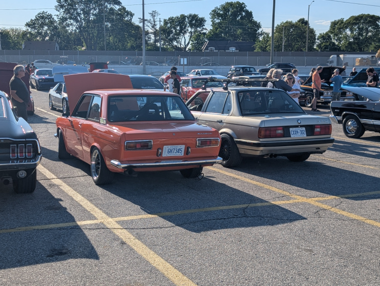

                              What is your ride height? and what bushes are installed and how old were they when you checked alignment?

                                sorry for the odd angled picture, RTAB are OEM rubbers, they aren't worn out, very stiff (had the arms out last year to replace but didn't bother).
                                The rear subframe bushings are Condor risers (white delrin?). Those were done last year.
