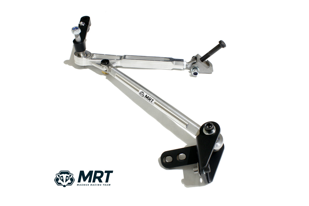

        Could this be an option? Seems a little less extreme
        BMW E30 / E36 / E46 - Roll-center / bump steer / angle -kit – MRT Engineering​
          It exists, thank you. Will begin to start saving the pennies.
