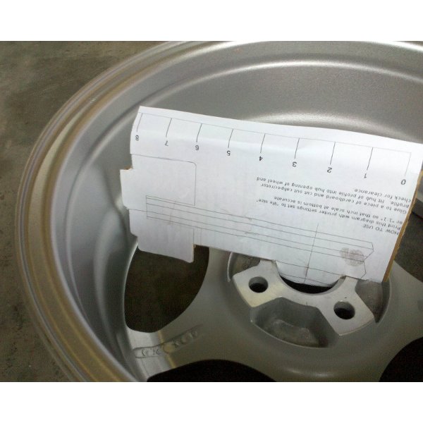

                  #83
                  I just test fitted the template to the TRM 15x8 wheel. it fits, but there is less than 2mm clearance at one specific point. the paper was floppy, so difficult to measure exactly. One thing to note is that the steps on the caliper front face are really well placed, they almost follow the barrel reinforcement of the wheel perfectly. definitely some effort put in there.
                  Rob, is there a built in tolerance in your templates? or thats the exact size as is? if so, do you think it would be possible to round off the sharp edge identified in the picture in future versions? i think this would be enough to get good clearance. i dont think 1-2mm is enough if you factor in bearing deflection.
                  if this kit fits this wheel, i think you will be selling alot more of these. it's gotten to be a very popular wheel with racers on the club, and im sure they would love to fit this much brake under them without having to go with spacers.

                    #84
                    seriously, if you printed that on any "normal" printer there could be a few mm of discrepency right there. you should use a calibrated plotter to ensure its 1:1 true scale. plus like you said its flimsy and hard to measure.
                    • nando
                      • 34839
                      #85
                      yeah I tried printing it at 1:1 but it still came off a tiny bit.
                      a cad file would be better but not many people have a real plotter..

                        #86
                        so did mine, about 0.5mm over the 8" scale. this just worsens the fit. nothing beats UUC actually trying the wheel directly.

                          #87
                          I'd recommend using some spray contact adhesive and piece of cardboard. Take a look at the web page, there are pics in the FAQ showing that method.

                          https://store.nexternal.com/uuc/imag...IT4_600.jpgRob, is there a built in tolerance in your templates?[/QUOTE]
                          The actual caliper does not go beyond the template... I'll take some close-up pics tomorrow to demonstrate.
                          That's the idea!

                            #88
                            I should post a simple 1:1 jpeg or gif. One thing I ran into was that I could print the image file perfectly, but the pdf would only print perfectly on some of the printers in the office, but not all (not the one on my own desk, fer cryin' out loud!).
                            Watch for that image file tomorrow when I am back in the office.
