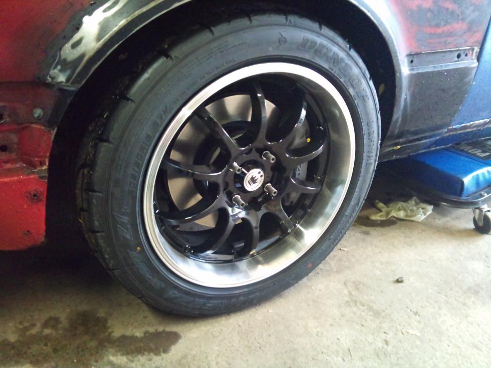

                    Here's a pic of my setup to add to the site (Konig Lightning)
                    I used the e34 M5 master cylinder (25mm i think?) Pedal is stiff and feedback is awesome. Shitty pads hindered me at the track but overall i was quite happy.

                      Sweet. Thanks guys!
                      I just updated the list and added the pictures. :)
