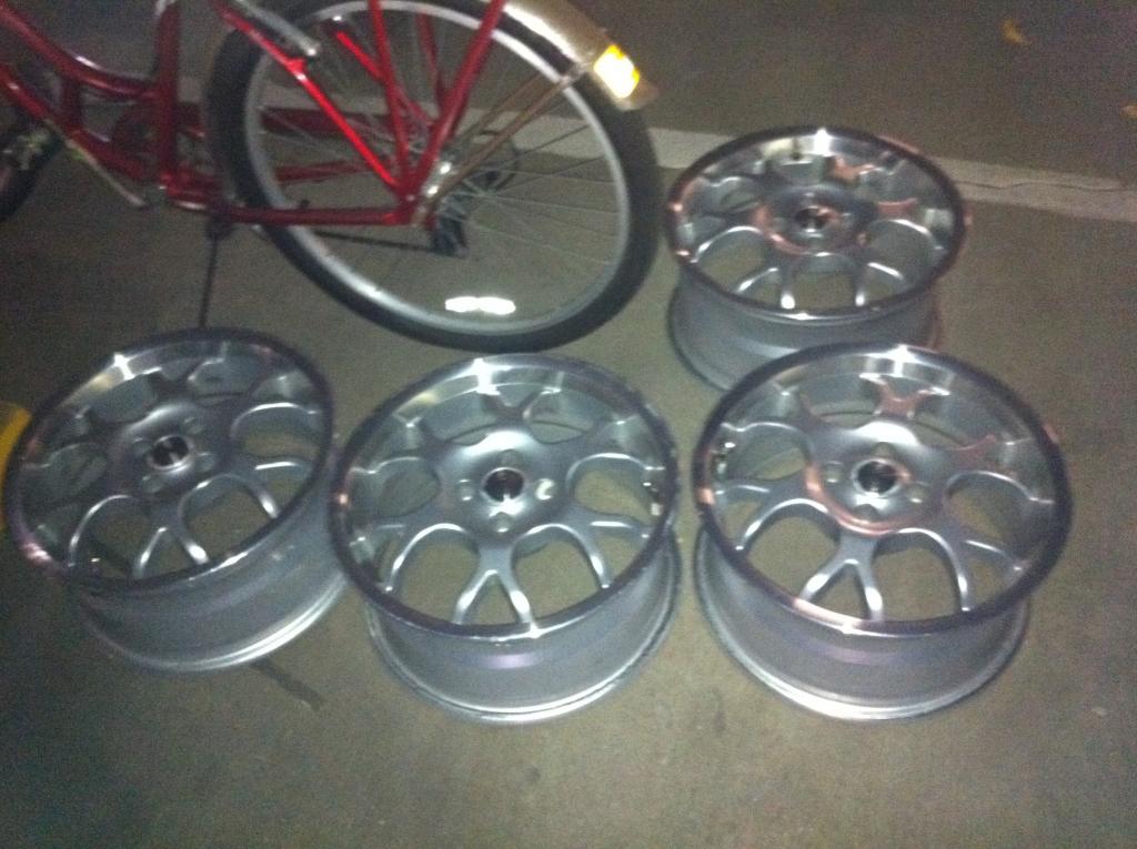

                          • fporro
                            • 1859
                            New rims for it :)
                            • ak-
                              • 12422
                              You been saving for 6+ years lol?
