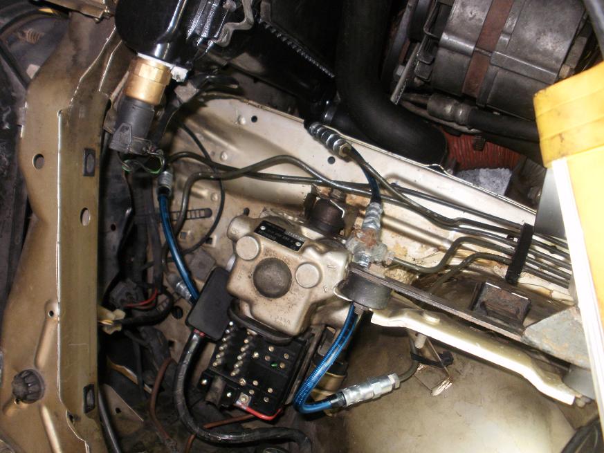

                    I could relay my really lengthy saga trying to get some pedal feel out of the brakes & air in the abs unit, but, really, ya'll would be asleep by the end of the story. Out of time and desperate for brakes before an event, with an extra set of ss-lines on hand, I bypassed the ABS unit. Last year I was determined to get it back, and opted to leave no brake-bleeding stone unturned.
                    Anyway - sitting here without pics and a bit from memory, what I did to get the abs unit to cycle was jumper 87 & 30 connections on the abs unit as shown in the OP's pics.
                    Obviously that means popping off both relays and wiring up some jumpers - easily enough done with some radio shack connectors of the right size & a short length of wire.
                    Apparently in shack-speak, these are either "Bullet" crimp connectors, or maybe "Snap" connectors, along the lines of:
                    http://www.radioshack.com/product/in...tent=CT2032231
                    http://www.radioshack.com/product/in...ent=CT2032231#
                    I had a selection on hand from which I was able to use the right size, but I'd have to go dig 'em up to be more specific on which connectors I used - I think they had yellow plastic on the bases for a larger gauge wire than the links above.
                    Jumpering like this is all done up at the abs unit, no getting under the dash or accessing the ABS electronic control brain/module in the interior.
                    The OP's pic shows the topside of the plug that plugs into the abs unit with the plug cover removed, and the plug still plugged in. I left the cover on & simply unplugged it (I think the cable is clamped in place with a plastic bridge piece secured by a couple of screws, maybe torx), and used jumpers between the plug and the abs unit (again, pretty easily wired up w/ right-sized connectors sourced from radio shack).
                    I ran two jumpers out of one connector for power rather than make up a jumper for the two power connections of pins/plugs 6 & 12. I just split the power coming out of plug pos. 6 to pins 12 & 6 on the ABS connector; these are the pins that get power to the relays/circuits, which you can see at the top of the wiring diagram at the beginning of the thread.
                    With the relays and power connections jumped, all that's needed to actuate the solenoid valves is to ground the pins for the solenoid valves in the ABS connector (at this point, I left the jumper for the ABS pump relay unplugged from one of the plugs, either 87 or 30, it doesn't matter which).
                    Since the pins in the E30 ABS unit are pretty-good sized, I think I was able to find a female plug out of my Radio Shack connector selection to fit pretty well without having to go to great efforts to make something fit. Come to think of it, I think I actually used a small alligator clip that had a plastic cover that would cover the full length of the clip & clip jaws. I ran a pretty good length of wire out from the plug for the solenoid pins as I needed to be able to cycle the solenoids while sitting in the car.
                    The wiring diagram shows the solenoid valves are ABS connector pins 1, 3, & 5. The numbering pasted in on the 2nd pic of the connector (1, 2 & 3) at the beginning of the thread are the wires for the solenoid valves, but do not correspond to the wire diagram or connector numberings. Both the plug and connector have numbered positions molded in that are easily seen, but you may have to look closely (they're small - see attached pic for reference).

                        A couple of addendums - I didn't broach removing the back of the wire harness connector; It would be possible to pull the cover as shown in the pic at the beginning of the thread, jumper both relays, and perhaps a small alligator clip (wired up with a long lead) might adequately grip the top of the plug connectors for the starter switch. The potential issue with pulling the connector cover off might be it re-installing as securely as originally. Perhaps the OP might comment if there were any issues with the cover going back on and being secured/sealed as well as it was originally. I could see potential for an issue with the old & possibly-now-fragile original plastic.
                        As an aside, if your connector to the top of your brake reservoir cap for the fluid-level sensor is intact, it may be best to just leave it attached. I tried to pull the wire off my E34 and it just crumbled between my fingers - oops.
                        The solenoids apparently take a little power - I initially tried a much smaller switch and it quickly got too hot to hold after repeated solenoid clicking. The starter switch handled the task without a problem.
                        The other thing that might be done is recruit _two_ friends, and have one tap the ABS unit while bleeding and the other friend tapping the caliper while bleeding, just to cover every base for knocking out air bubbles.
                        Found a picture of my bypassed ABS unit before putting everything back, with the relay/connector cover removed, and the cable connector removed from the ABS unit. Mentioned earlier, but pin numbers are molded in next to the pins, although not viewable in this pic. '87 325is, prod. 5/87 - for me, the cruise control is not in the way for accessing the ABS unit.
                        Bypassing the ABS unit yielded a rock solid brake pedal; the problem though was, not surprisingly, no ABS. I didn't have much problem managing front lockup in the dry, but nearly every heavy braking application ended up locking up the right rear wheel with accompanying big cloud of smoke off the rr tire, flatspotting every time. Corner weighting might have helped, but putting the ABS back was a better option.
