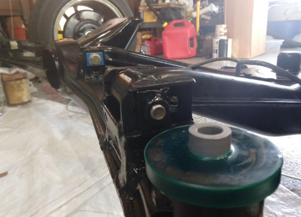

                        I finally did get this done. Used the IE slotted adjusters and welded them in 12mm higher than stock. I did need to bias the toe adjusters forward and relieve them slightly to clear the gas tank.
                        Everything is installed and using my magic alignment string I have -1/16 toe and 2.5degrees camber per wheel, which is about exactly what I wanted and I have plenty of room for adjustment.
                        You will notice from the photo that:
                        1) the nut side of each bolt is welded in so that these are single-wrench adjustable. Works dandy!
                        2) There is extra welding material and general strengthening at the base of the bracket. I realized that mounting these 12mm higher increases the lever-arm of the bracket assys so that there is more torque on the subframe during braking/acceleration, and there will be more of a reaction force at the differential mount. I will be keeping a close eye on it this season of HPDE to look for issues.

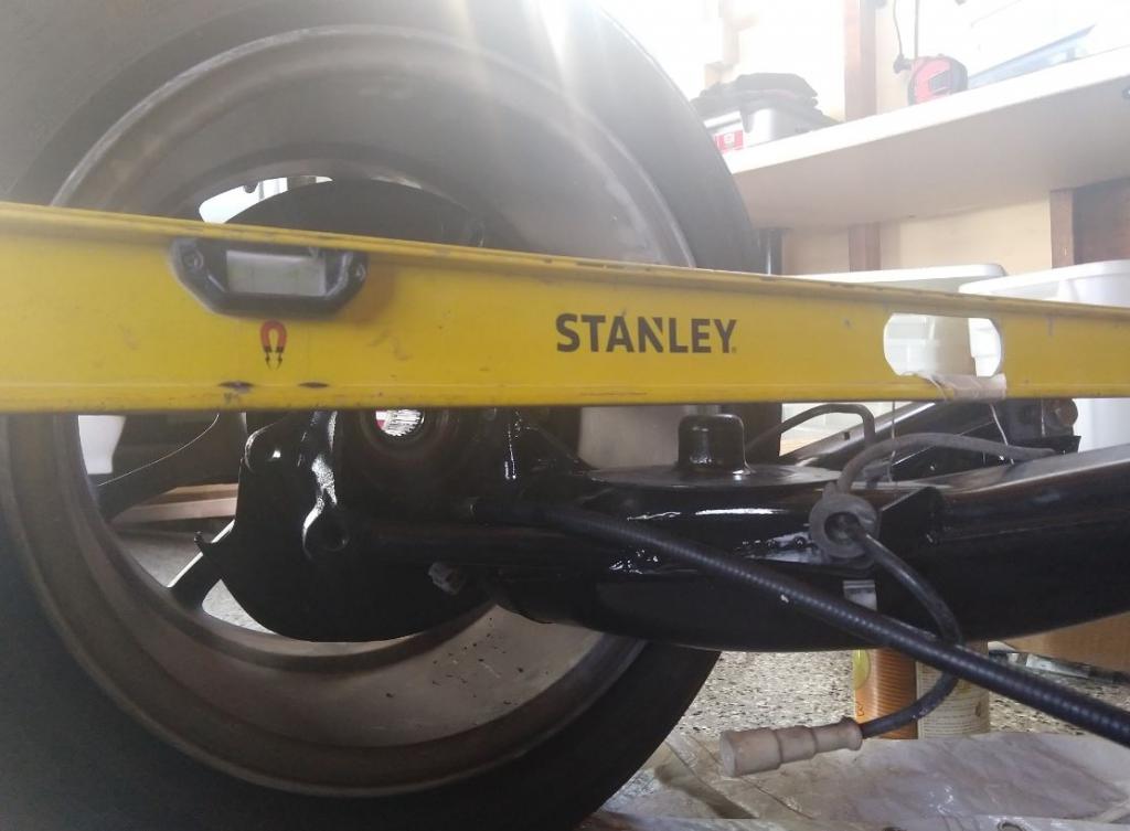

                          Just for fun.. what's the relative position of the TA pivot to the center of the wheel bearing? Perfectly level!
