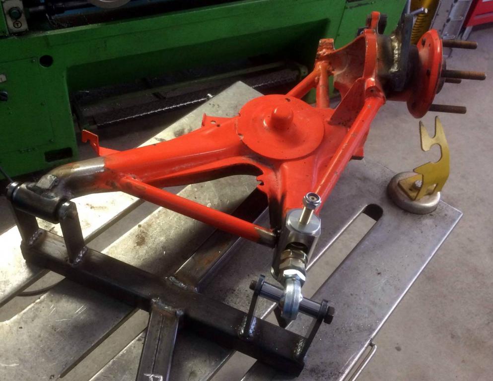

                Instead of the slotted TA mounts, you should consider the DTM style adjuster. Can't remember who, but some vendor has it for $200 or so, and adjustment would be so much easier.

                            Originally posted by hoveringuy
                            THAT is the way to do it.
                            Actually its improved on the original design in the 1st Gen Gruppe A training arm, there appears to be an additional threaded adjuster in this version that makes it much easier to adjust toe.
                            Jimmy P.

                            • AndrewBird
                              The Mad Scientist
                              • 11898
                              Yeah, that DTM adjuster is awesome. Camber and toe adjustable from one side. I'm already thinking about how I could replicate it. I wonder if it's $230 per side or for both sides?
