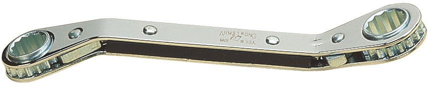

        one of these in 7/8 does the trick. much better than an open end wrench.

                  it just takes time. lots and lots of time, and a stuby open ended 22mm wrench.

                        Shit, guys, the bent 22mm end wrench takes me about maybe 8 minutes to pull a ball joint nut.

                          Dude, you must have some huge arm power. Or some way to brace yourself. With my car being on jack stands (not really high either) going though the engine bay was the only thing that was working. I also had a bent wrench.

                                I just use a stubby 22mm, with a 24mm hooked on it to get leverage to break it loose. Then just use the 22, all from underneath. Replaced the arms 3 times with no problems, other than the extremely limited room to move the wrench, so it takes forever.
