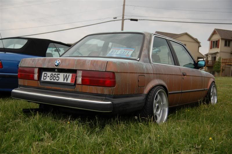

        A buddy of mine just sent me this - to clarify things for others thinking about the GC + E30 Bilstein Sport setup - here's them on the lowest setting on his car
        That's shit. I can't justify rocking nice wheels with 2" of wheel gap and NO suspension travel. Looks like I'm going to be taking a $140 hit from the welding I got done.
        I need SPECIFICS on the G60 setup. Can anybody help me out and put down some actual #'s?
        He's obviously not running camber plates or he's running really long springs. If I had lowered mine all the way the IS lip would be about 1/2" off the ground.
        • Moto-Mucci
          • 2058
          I have the same setup as him - HD control arms with M3 offset bushings, and a bunch of other new stock ish. So no camber plates.
          And I'm going to assume I'm in the same boat as him since the GC only coil down 2.25" and this is my stock ride height:
          That's def going to need more then 2"

                            The amount of camber in the above shot is what I'm looking for anyhow, that's what's important. Enough to get 9's in back there with a good drop and not have to worry too much about rubbage.
