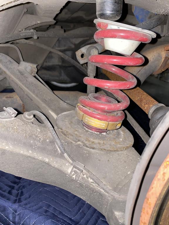

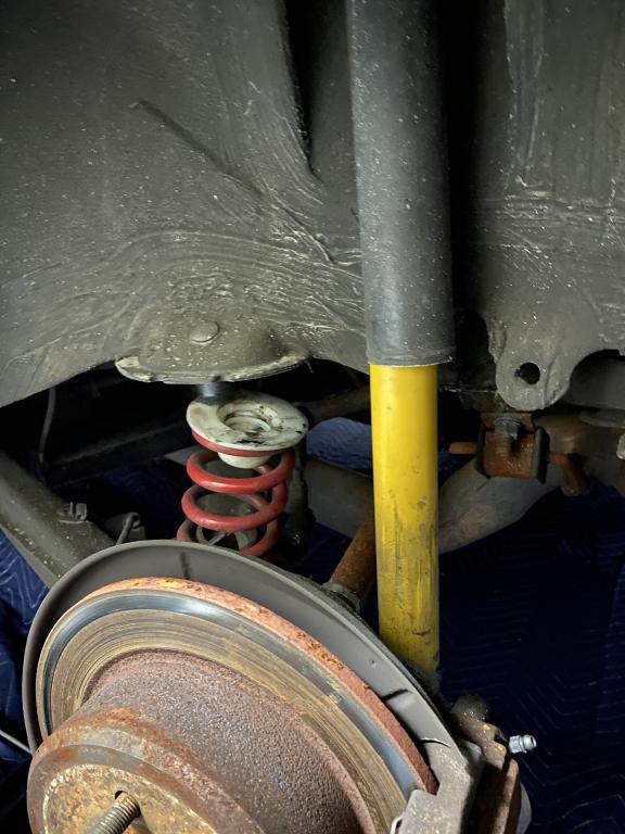

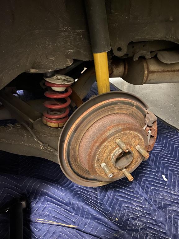

              Jacked the car up, to find Bilstein struts with Eibach springs on a GC setup.

              • Northern
                I like cupcakes & sh!tboxes
                • 5247
                Adjusters could be seized, but it looks fairly new? hardly any rust on the springs.
                The shocks could be blown? You can pull the PN off the shock body near the bottom, it's probably not a stock e30 shock in the rear, but the -1186 part number from this thread:

                • E30andy
                  • Aug 2016
                  • 504
                  You are running a nice upgrade from stock. Proven to work well and pretty bulletproof. If the suspension feels good, why change it?? The only thing that can go wrong here is a worn out shock, easy to replace those bilsteins. I guess the question remains why did your shop suggest replacing the suspension?
