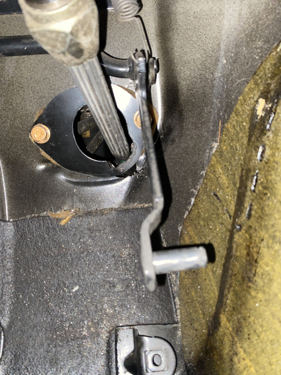

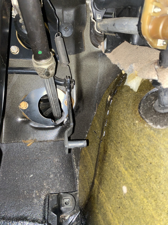

                • aavani90
                  • Oct 2020
                  • 111
                  Originally posted by E30SPDFRK
                  No need to remove the rack to remove the column on an airbag car, you can loosen the compression nut under the kick panel, remove the joint from the rack, then pull the bottom of the shaft out from the bottom. Hopefully the PO didn't cut the mounting nuts off the firewall when they mangled it; you get close to the inside one when opening up the hole.
                  Good to know, thank you for that. No the nuts are still intact, here’s a pic for reference what I’m dealing with. Not as mangled as I make it out to be, but definitely a little ugly. I’m going to be buying the plate from Matt@EDC, now I just need the boot if you have any idea where I can find one since they’re back ordered everywhere.

                  • aavani90
                    • Oct 2020
                    • 111
                    I’ve been searching for a DIY explaining how to separate the steering column so I can swap out the firewall plate with the offset one I got, but can’t find a write up. I’m not trying to remove the whole column, I just need it to separate like an 1/8” inch to be able to slide the new plate on there and remove the old one. Would I still need to remove the rack joint and pull the bottom of the shaft out? This is my first time messing with a steering column, if I loosen that big lock nut will it separate the column enough to slide the new plate on?

                    • E30SPDFRK
                      • 5705
                      If the steering rack isn't out of the car, it will be more difficult to get the bottom half of the steering shaft out, but it is still possible. Loosen that big compression nut holding the 2 halves together, and the lower part will slide in and out of the upper part. The grease likes to dry up and turn solid over time, so you may need to heat the upper column by the compression nut with a heat gun to get it to move. Remove the shaft from the lower U-joint at the rack before sliding the shaft out the bottom above the rack and oil pan. If the splines were stuck from the old grease, clean both halves of the column well and re-grease them before you reinstall it.
