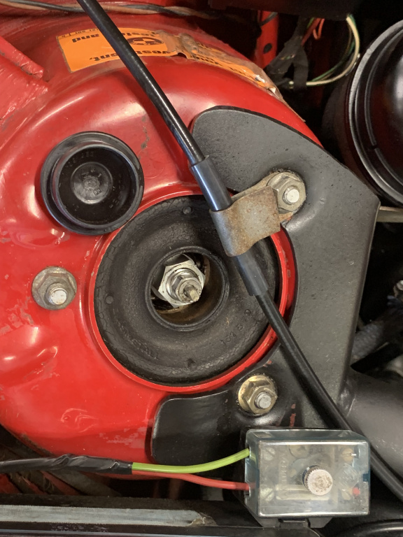

                A bit late to the party but the yellows speced for the cabrio are not externally adjustable...which means removing the strut assembly to adjust. If it's not too late get the fronts for the sedan. The difference in valving is negligible and at least you can adjust them externally Click image for larger version
                  Yeah, I found that out. They arrived and went right back. "Dissassemble the strut first" does NOT equal "adjustable."
                    It is technically adjustable. You just have to get to it lol
                      I called them "theoretically adjustable." No way in HELL I'm pulling struts and compressing springs just to try another quarter turn adjustment.
