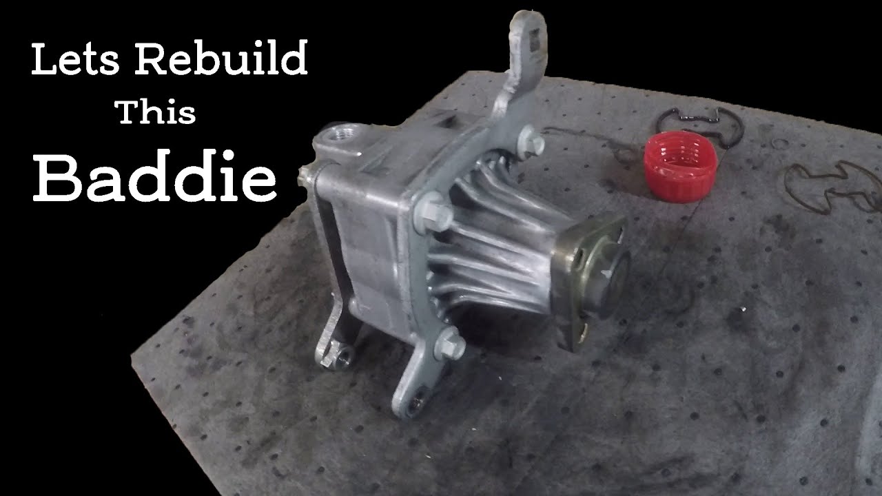

          I rebuilt Vickers pump with OEM kit, CH11s. It's pretty simple process and no issues after the rebuilt, it turns Z rack on my car nicely.
          here is a video from someone that should give you an idea of the process.
