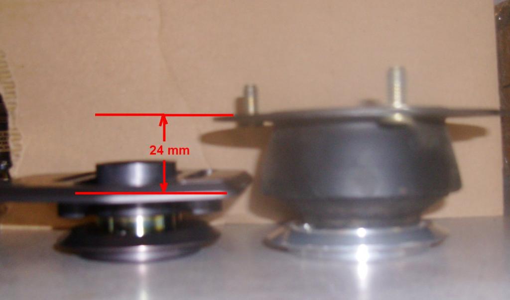

            Aren't IE camber plates notorious for adding lots of stack height?

              • nando
                • 34839
                yep, I think they raise the front of your car by about 1". try GC or vorshlag if you want to lose the gap.. or shorter springs and less travel (not a great choice).

                  • 18403
                  Looking at the picture, I would say yes. There's is an inch or two in that camber plate that you do not have in GC's...

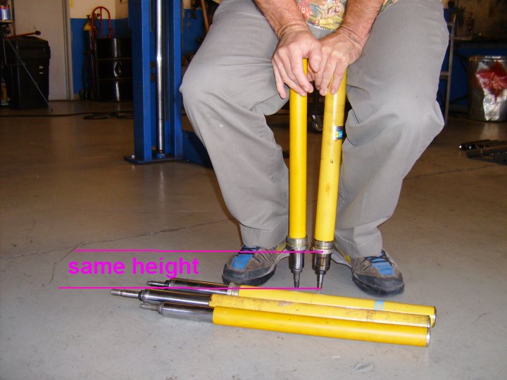

                    There is whole thread about this somewhere with pics. I can't find it right now. Search for billie bump.
                    But.. until then, check that you don't accidentally have 2 spring perches up top. But also, you may just be on the Bilstein bumpstops. The car will sit onto them sooner than you expect.
                    I have attached a pic of me pushing on Bilsteins until they bottom out. You will notice there is a lot of Chrome Bilstein shaft still showing, but inside they are stopped.

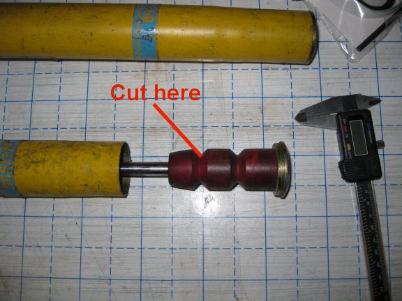

                      here is a pic of the bumpstop inside.

                            • Hellabad
                              • 807
                              Originally posted by e30this
                              Im not running ANY bump stops.
                              On the front Bilsteins, they are inside, you can't see them
                              So if your shock is showing that much when it is bottom out then Im sure my shock is fully compressed because thats all that I have sticking out of the top of the shock.
                              Exactly. Thats why I posted the first pic, it is easier to understand.
                              Im going to pull shit apart and check it out later tonight...
                              Thats why I posted the second pic! Cut that with a steak knife, don't cut more than that.
