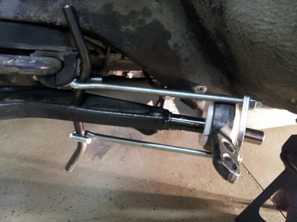

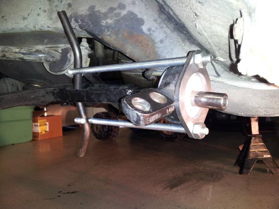

      well, in the interest of putting more information out there, here's a pic of my "special tool" that I made out of stuff sitting around the garage to pull the M3 offset bushings on. A bit cumbersome, but it worked pretty easily......
      parts: some threaded rod, some nuts and washers, a drilled out "L" bracket, and......a hub from a 1970 Triumph GT6, that happened to have a perfect inner diameter for pressing the bushing/lollipop on - and of course already has a really strong/stiff flange with perfectly spaced holes in it :)
      EDIT NOTE: The car is on jackstands (just out of the picture), the jack in the photo is just there as an extra "safety net" :)

        ^Buy some jackstands. ;)
        Originally posted by Matt-B
        • irish44j
          • Oct 2011
          • 2763
          #34
          lol, I knew someone was gonna say that when I looked at the pic and how it was aimed.
          But rest assured, it's on jackstands, you just can't see them in the pic. Jack was just there for an extra safety net since I was pushing and pulling on the car alot, and I had to move the stands back slightly on the rails to get some room to work. ;)

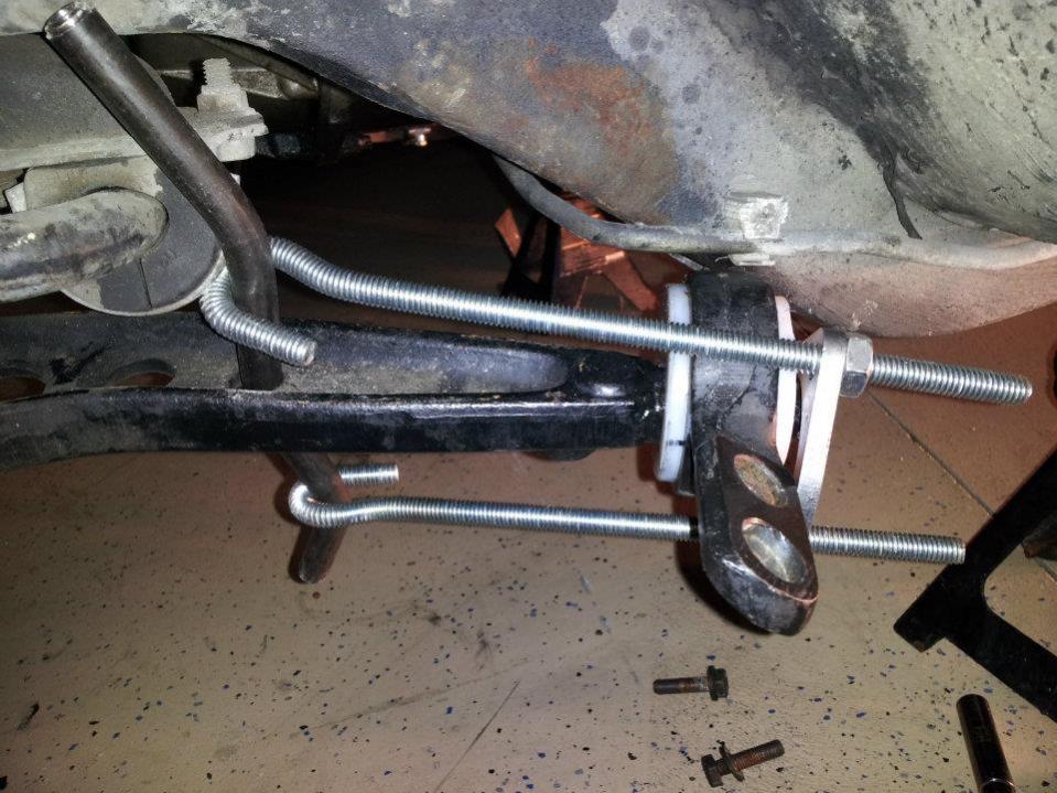

                    I made the same kind of rig for my cabby's
                    I worked really well.....:mrgreen:

                      Haha, I like your setup MonkeyMadness!
                      • MonkeyMadness
                        • 3251
                        #41
                        thanks..;)
