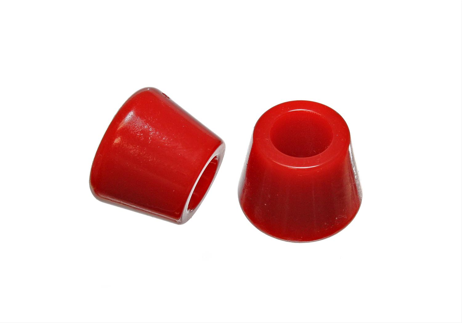

                                #45
                                I have the stock bump stops with the center bubble removed. I think I'm going to snag some of these and modify them to be a little softer up top.
                                I'll probably get some shorter inserts next time around. The amount of travel I have now is unacceptable.
                                Free Shipping - Energy Suspension Bump Stops with qualifying orders of $109. Shop Frame Bump Stops at Summit Racing.
