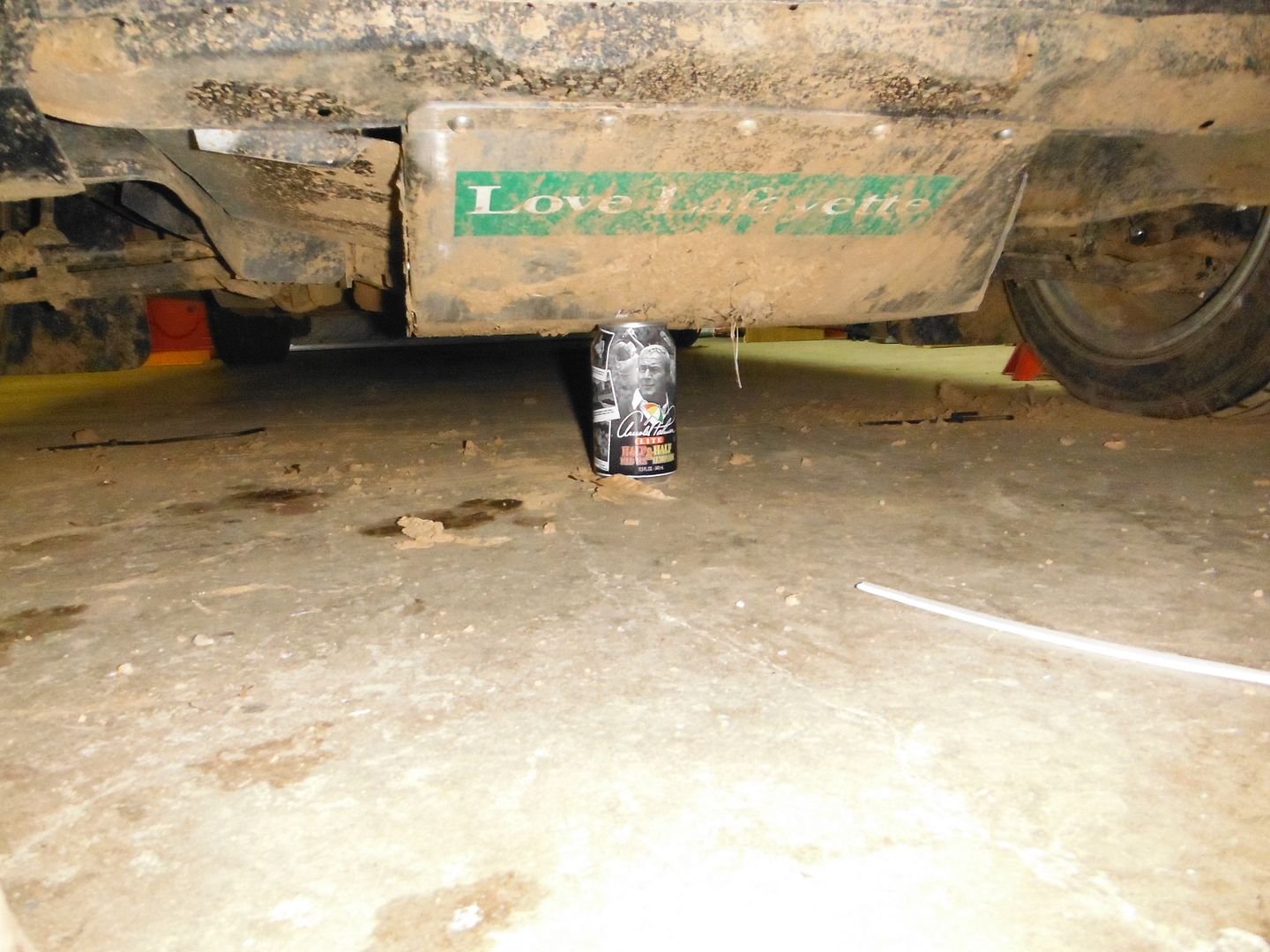

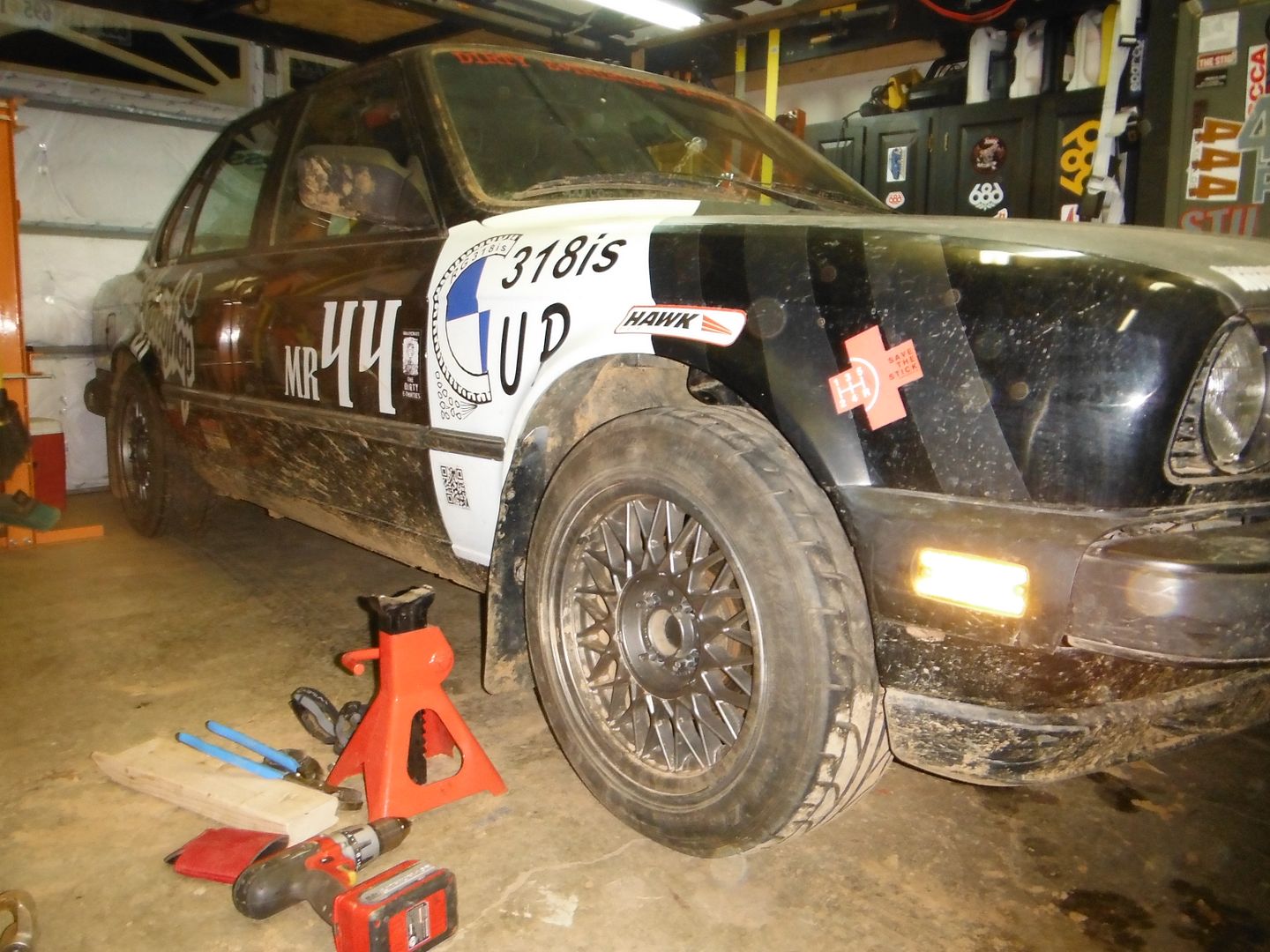

    FYI, I decided to use 1" spring spacers from Jegs....they're pretty hefty pieces. I installed under the spring on the seat and the "stance" is perfectly even (measuring from the rockers, which are exactly the same height front and rear now.
    No good pics of the car as a whole, but here are a few shots:
    I also put some retaining tabs on the spring seat since this is a rallycross car and I need to make sure the springs stay where they need to stay (better safe than sorry)
    as you can see, still have plenty of clearance under the M42 pan and skidplate :)
    Fender height in front with the spacers is about 14.25" from the hub center..so it ended up being about a 1" drop up front instead of 2+" like it would be without the spacer.
