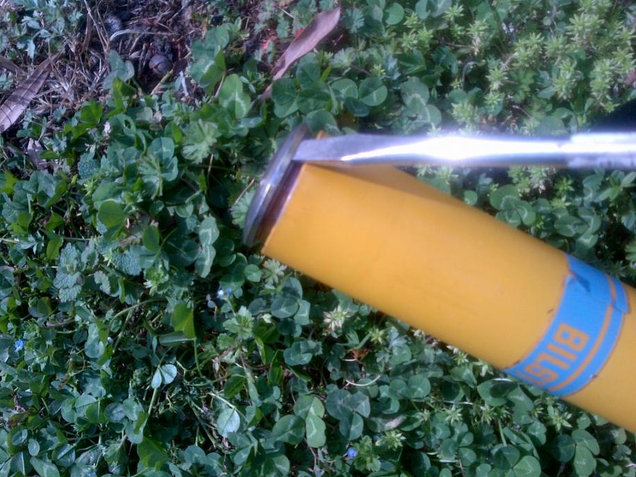

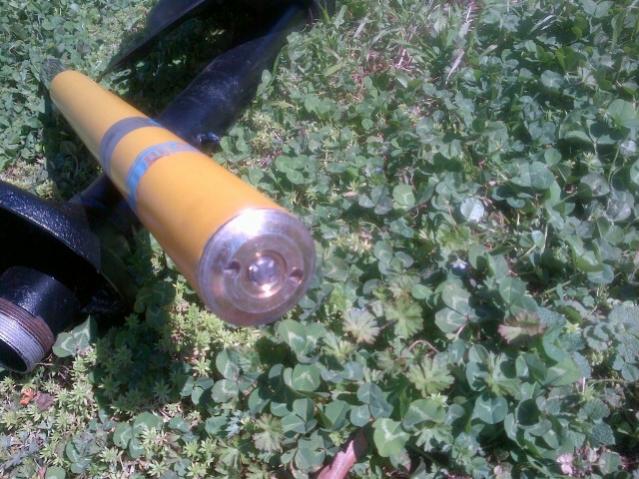

      It's pressed in , not screwed in. Get a chisel or similar and gently drive the silver cap off. It is attached to the damper rod and you are not entering the fluid cavity (pressurized) part of the strut. This will expose the bump stop, remove however much you want with a razor blade.
      Edit: Also, the yellow outer shell is just a covering, It's inner surface is not what the shock piston rides on (seals against) like a conventional strut. Gently clamping it in a vice is fine.

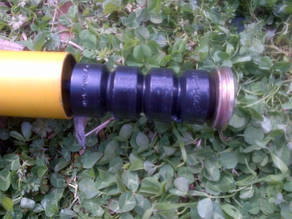

        There was no lip per se but a few gentle taps at almost a 90 gave me enough room to get the screwdriver in there. I had the yellow tube on a 2x6 held down just with my foot.
        It is very soft rubber yet hard enough to jar my bones when I hit a pot hole. Im thinking to remove the bottom half rather than the top.

        I withdraw the question. The top is flat and if I remove the bottom portion there will still be a taper left at the bottom.

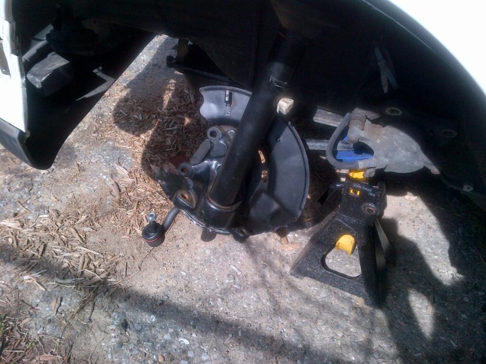

            Pics make all the difference. This was a breeze, especially since the strut was already out. Doing it from scratch I'd say an hour\side plus PITA time depending on how long it takes you to get unbolt everything. My tie rod end and ball joint dropped easy. Unbolting the strut retaining nut without a special tool took...well...days. In the end I grabbed the shaft (strut that is) with channel locks just below the top spring pad where the model # is (so as not to damage the important part). Then w a 19mm socket I just gave it a sharp smack with a 3lb masons sledge.

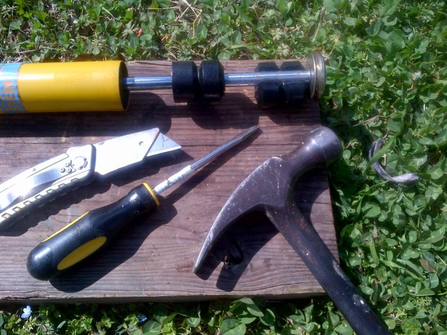

            The 1st pic shows you how I cut it along with the special BMW tools I used. Just ask for StanleyEstwingXacto (SEX for short:)

              For what it's worth, I used channel locks to grab the bottom cap and twisted it off.

                I did try that. Perhaps its cause I have the 30mm strut or just the way the Sport is built, but I couldn't get a decent grip on it.

                    The half I just removed is 1.5" so figure 3" on a Bilstein Sport PN P30 0334 HO. Keep in mind thats for the 45mm housing and is a 30mm strut VS 36mm for the ones that go in the 51mm housing. The PN on this stop is B36-126A 6 FWIW
