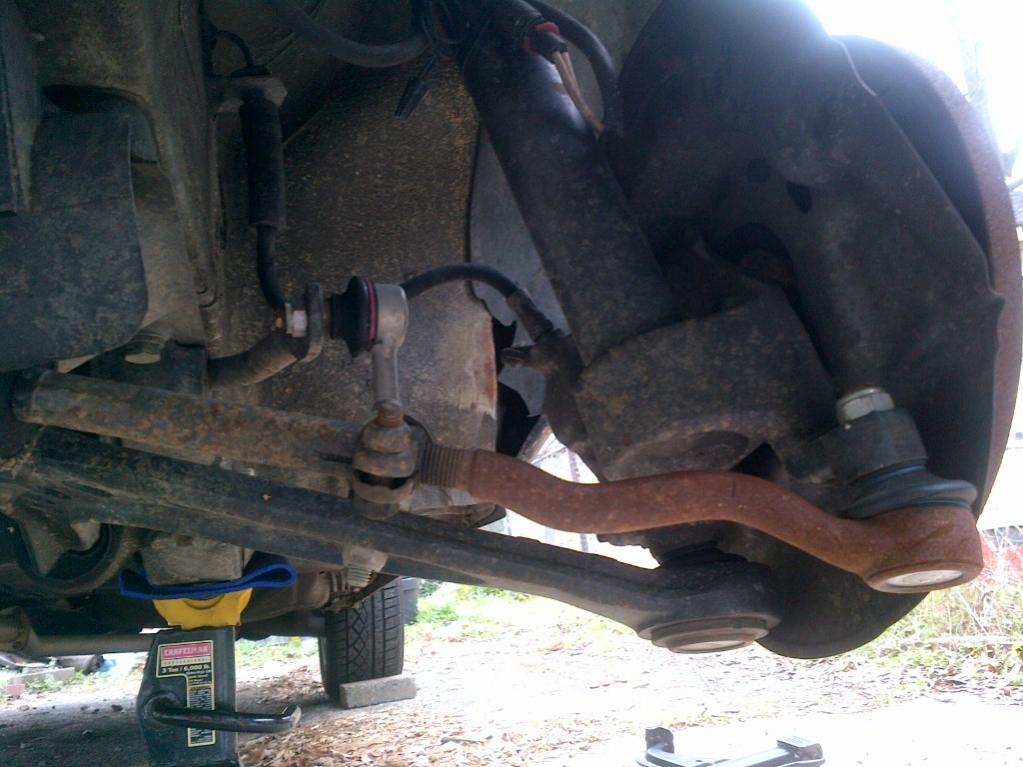

            I'll try to explain it as best as I understand it. When you lower your car your change the relationship between the control arm and the tie rod away from parallel (or close to it). When the car is in transition (ie cornering) these 2 parts, if off plane, will respond differently so if you hit a bump, it will generate disproportionate feedback tot he steering wheel as if the car is trying to steer itself...ie bump steer.
            I didnt know I had bump steer until after I upgraded to an e36 rack and cured it, by inadvertently compensating for the lowered car by putting the spacers above the rack (as opposed to the often recommended bottom placement).
            I took the pic after the rack swap and you can see that the tierod and control arm are pretty much parallel. Now when I hit THAT bump at 50mph on the interstate on ramp the car is rock steady.
            Bump steer 101 as I know it.

              I will share my steering geometry picture because putting the spacer UNDER the rack is what fixed mine.
              Spacer ABOVE rack (bad geometry)
              Spacer BELOW rack (better geometry)
                Yours is shinier than to say the least. I tried to put the spacers underneath and there was no way to get the rack up that high without it hitting the pan. Keep in mind that thats an M10 and the rack I removed has a steel tubular body rather than cast aluminum so maybe it mounted differently in the beginning.
                Honestly, I never thought about angles at all til after it was all done so i just got lucky in eliminating the bump steer I had for 7-8 years even though I didnt know I had it til it was gone

                      I was looking at the pics posted by Sagaris & myself & I realized that his wheels were turned slightly whereas mine we dead ahead which perfectly illustrates how bump steer can occur. The outer ball joint and the tie rod rotate on different axis' so that as you turn the wheel, your toe & camber will also change. Thats why the angle in his "after" pic is noticeably different from mine.
                      Now imagine the wheel turned even further with a corresponding increase in that angle. As you turn, the ability to keep the knuckle stable is reduced so when you hit a bump its shakes. Think about carrying a heavy object above your head with your arms extended at 45 degrees, then again with your arms at 90.
                      Bump steer 301 !!

                        I think the discrepancy in the angle is more-so due to the fact that my car is sitting on the ground and yours is in the air with the suspension at max. travel.
                          That's part of it for sure as well as different suspension components etc. Suspension geometry seems to be part art part science, so every bit helps. Thanks.
