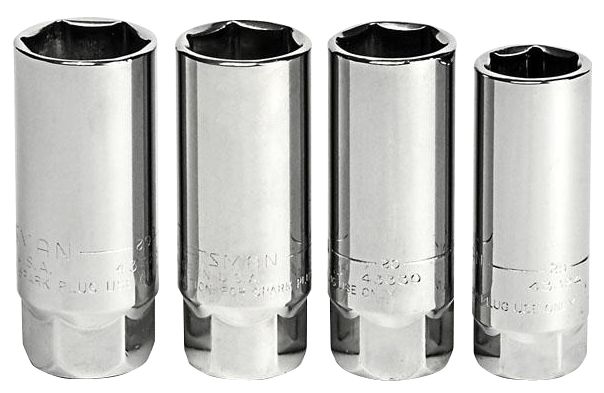

                              19mm = 3/4", or close enough to it with a 6-point socket
                              Use a standard sparkplug socket like this:
                              Insert the allen wrench down the middle, but a box end wrench on the socket and tighten it right up.
