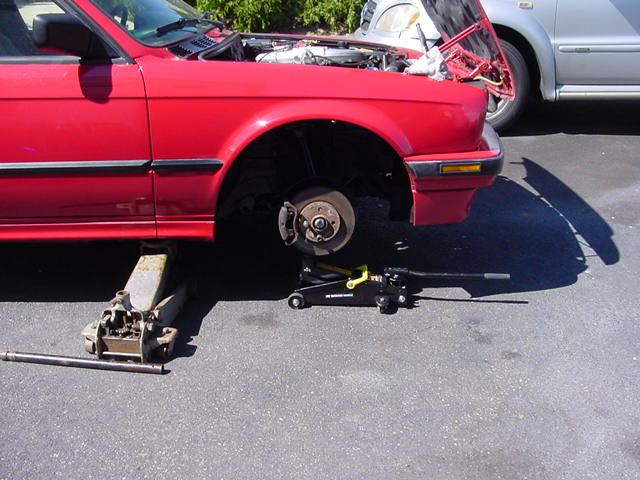

1) jack car up take off wheel
2) use another jack and jack up the control arm

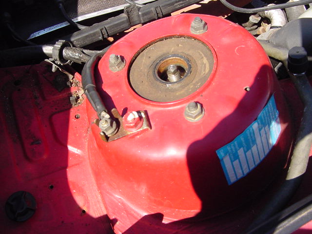

3) Undo the top central nut at the top of the strut

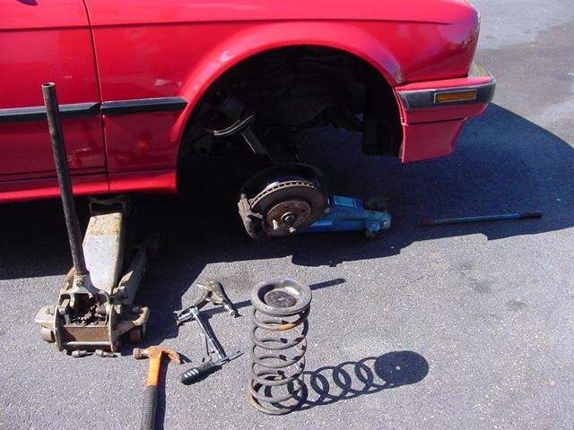

4) Slowly jack down the control arm until the spring decompresses completely
5) Remove the spring and cut the dead coil... i used my dremel
