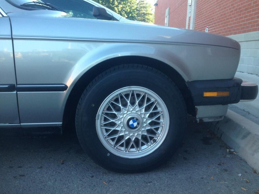

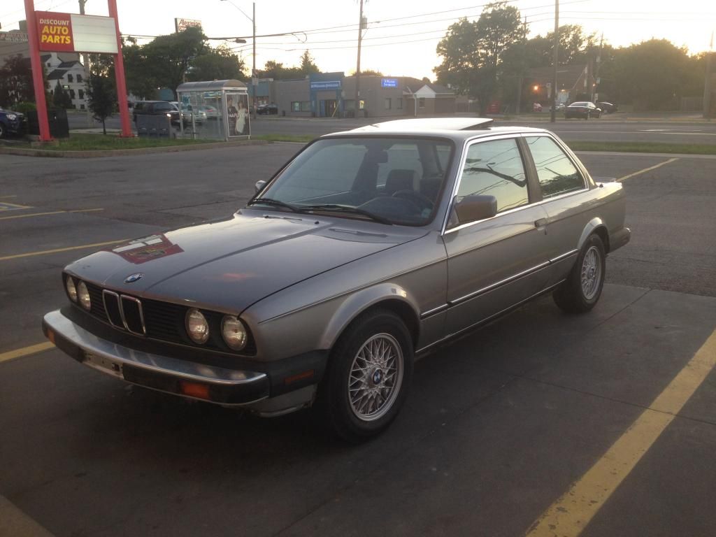

    i have an 88 325is i want to drop an inch or two.
    what type of springs are usually best used quality and price wise ?
