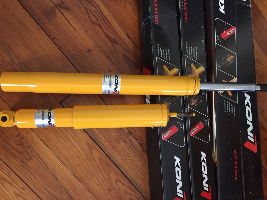

    in for comparison^^

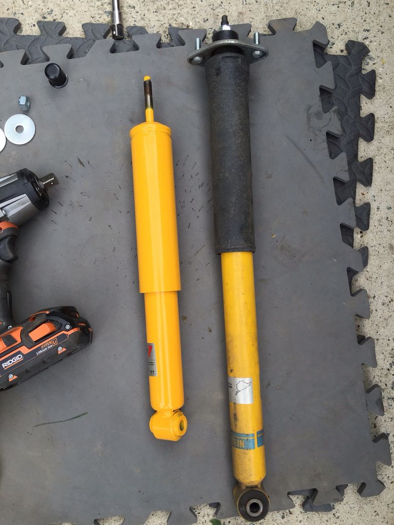

            These

              YES! im super excited to see how the hydraulic shocks feel in the rear, instead of the gas shocks of the bils

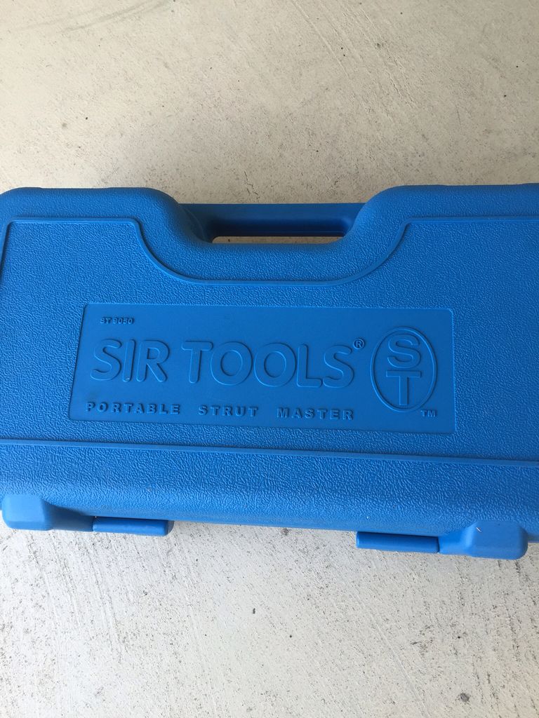

                Hey, what spring compressor is that?

                  SIR Tools. It's rated for impact wrenches and weighs about 30lbs. It's industrial grade and not much risk of it breaking

                    Alice the Time Capsule

                      I likey, but as few times as I would use it I can't justify the cost.

                        I got this one off eBay from a pawn broker. It looked to be new (it still does) and should still be worth what I paid for it.
                        It's probably over kill and for sure hard to justify the price for non commercial use, but after using the HF tool by hand enough times I swore "never again"

                          I got the rears in today in about an hour. No mystery whatsoever with the install but I did call Koni for clarification on adjusting them. There's a split nylon washer I R the upper housing that has to be removed before you can adjust them.
                          From there, despite what the pictograms and videos say, there isn't really a pronounced notch for the adjuster to lock into. It's more like a subtle detent so you have to screw around a bit to make sure your in it. Then you need to keep firm compression to insure it stays engaged. I was told you cannot turn it too far despite the adjusting range being 2-2.5 turns. This makes it a little tough to know when you are at full soft or full firm. Eventually you stop turning the. Back up to get it where you want it. I'm at 1/2 turn from full soft.
