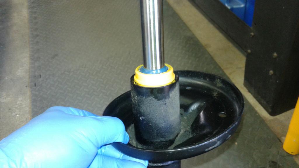

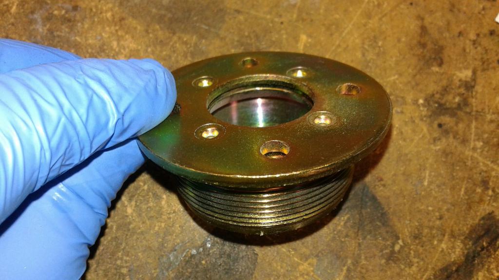

                                Can someone tell me wtf is going on?
                                I wanted to assemble struts today, but the gland nut won't fit with the inserts. Car is an "is" so I ordered the non-sport part # cause I knew the Bilstein style won't fit. Filled with 2 tbls ATF and slid in the Koni insert, put spacer on top of insert-but this happened. Do I need the other hex style gland nut?
                                Even with the spacer removed, the nut won't thread far enough in.
