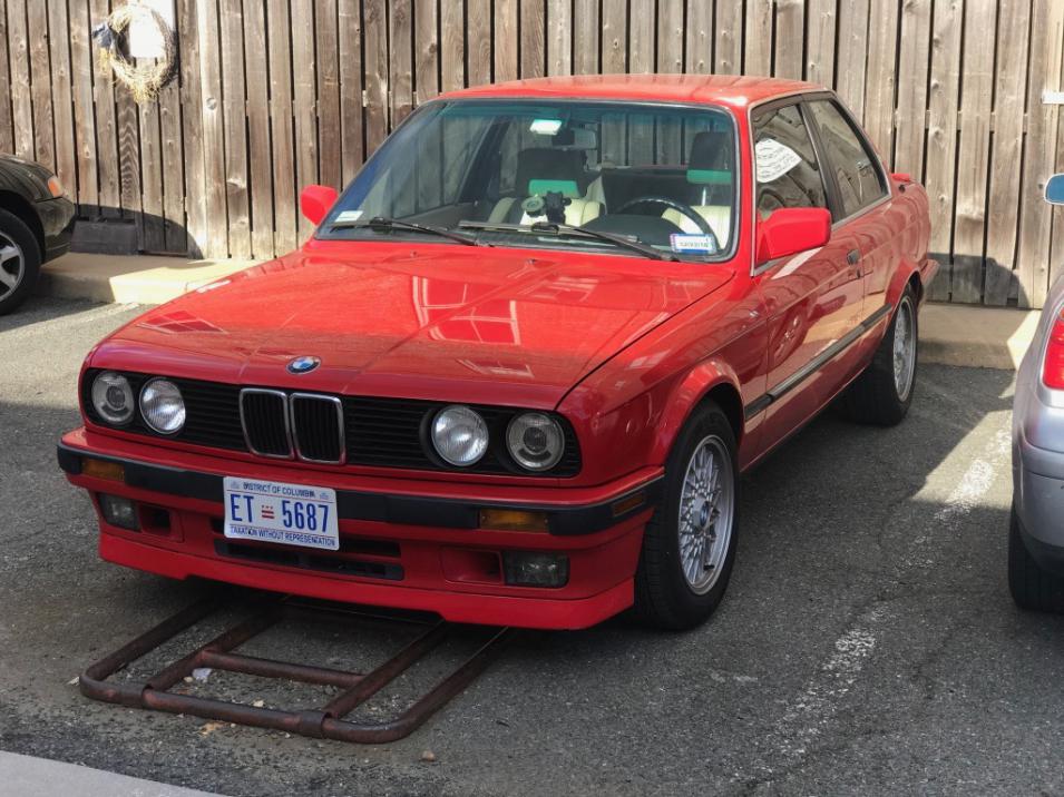

            Attached is a random picture that I just happened to have of my 325is on E30 M3 springs and Bilstein B4s.

              Lovely! I've never really been partial to brilliantrot, but man you're turning me around on that!
              As far as the ride height, it still looks a little lower than what I think I'm after, particularly in the rear (but with the angle, who's to say definitively?).
