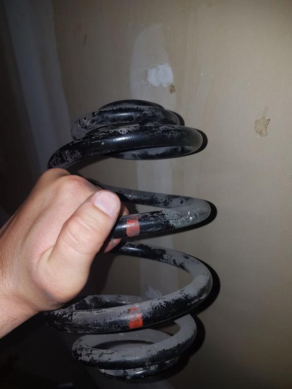

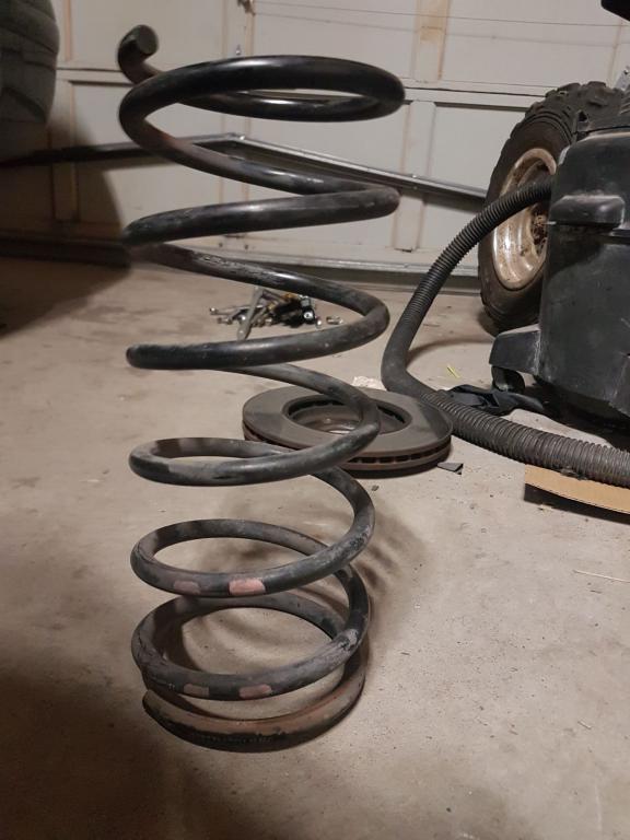

    The front springs are stamped "BMW 11327422RBW 46 C" and marked with 4 hot pink dots.

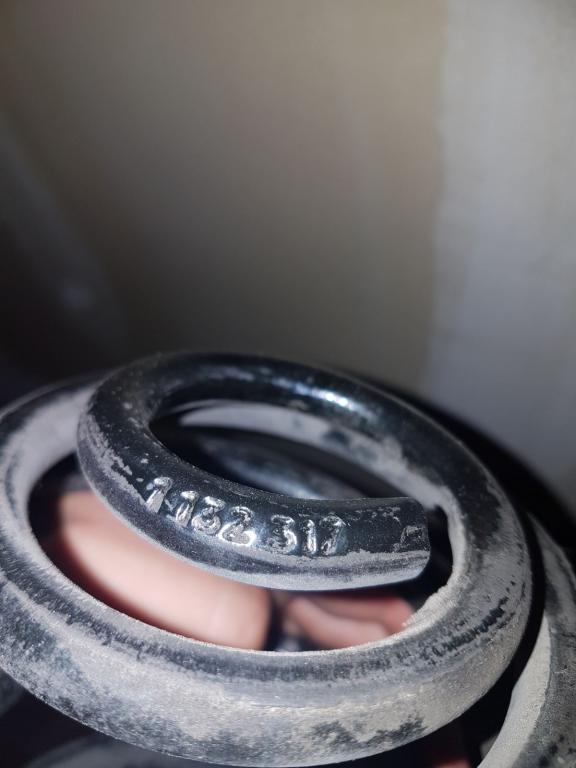

    The rears are marked 1132317 and are marked with 2 red dots.
    Anyone have a way to look these part numbers up?

                            HR OE sports, Mtech, S704 M sport suspension springs.
