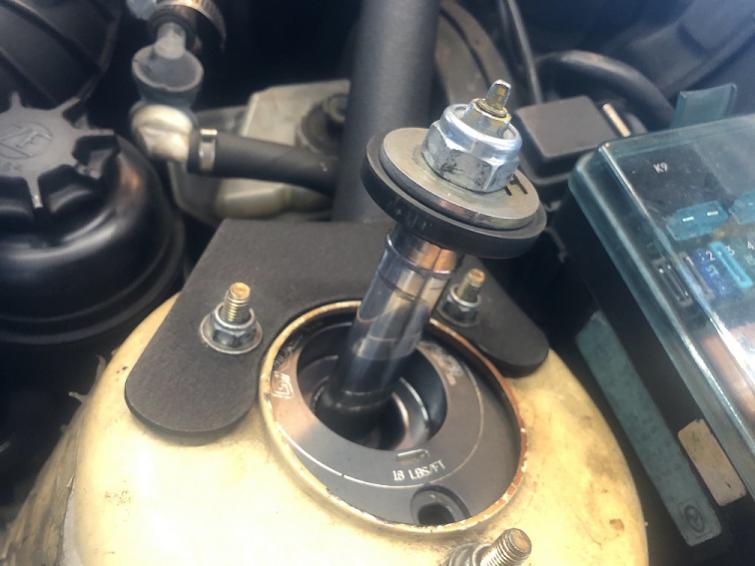

    Has this happened to anyone else? Sorry if pics r huge, can't really deal rn
    Shortened struts (by ground control), coilovers by ground control, sport camber plates by, and personally upsold to me by ground control. All items bought direct and professionally installed by two different bmw-only mechanics with excellent reputations in the Bay Area, California, USA.

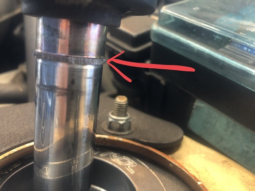

    Somehow, the whole works seems to be riding on the 1/16" of metal as shown by the red arrow. This is where it breaks every time, leaving me out parts, (Ground Control will not comp the $30 insert to a multi-car kit customer), labor, and an alignment for a nice swift kick to the nuts at the end.

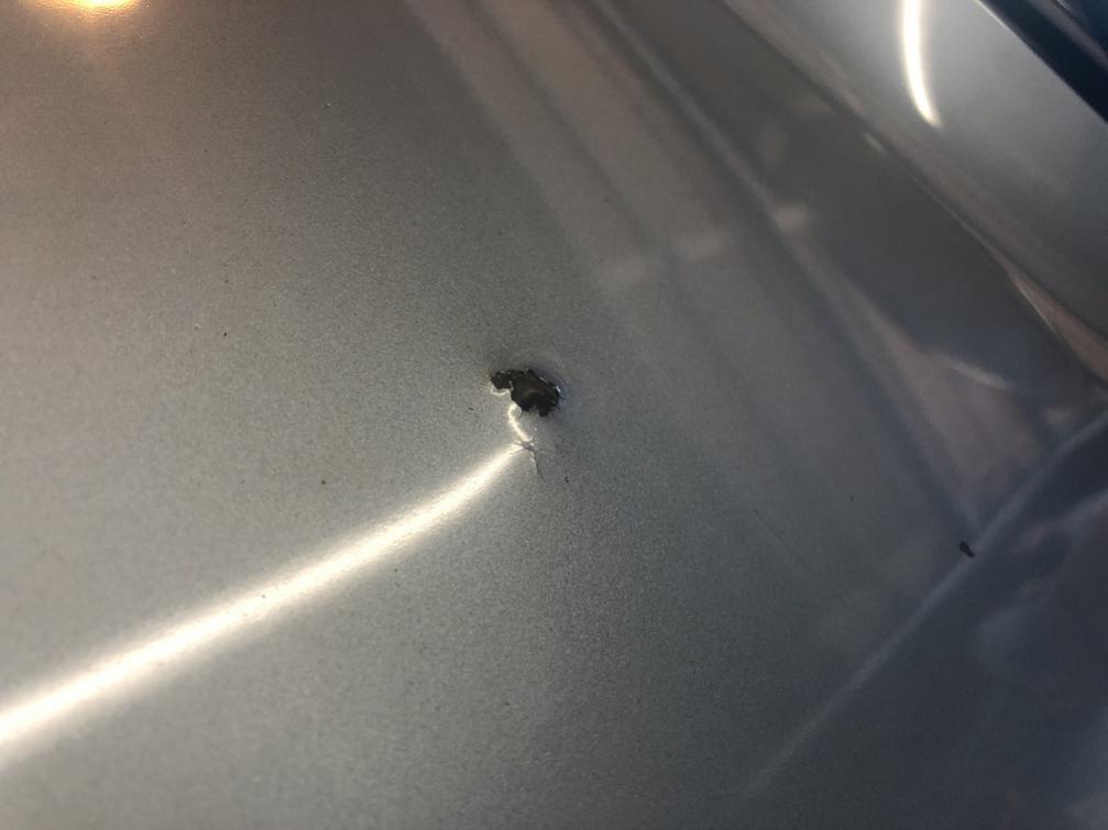

    Thankfully i haven't fixed the hood before any of these times.
    I guess mostly I am asking for a recommendation for aggressive-street (driving not parking) camber plates that are NOT by Ground Control, but compatible.
    Thank you very much in advance for any help. This car is my daily and my favorite car.

              Is there something wrong with your strut? That should not be a heavily loaded spot on that camber plate design. What's going on with your bump stop?

                Bit hard to tell what the actual failure mode is there. are they relying on that weld you have pointed out to take the full force of the front suspension?
                On DIY coilovers i have been involved with there is a shoulder on the shock shaft that sits up against the camper top bearing. So it is the spherical bearing (inside the plate) that takes all the force, not a weld like that.

                  That’s a shoulder on a machined insert that has sheared off, not a weld.
                  The springs on this camber plate ride on a perch that is on a BMW OEM type bearing, so the strut shaft is ONLY loaded with strut loads. That’s why repeated failure here is so weird.

                      If that's only strut loaded then is the strut bottoming out?

                          I've been running these for about 15k miles with no issues thus far. I'm inclined to think this has to be a bottoming out issue, I don't know how that much force could be translated to the failure point otherwise.
                          I would have your struts checked out, especially since you had them modified by GC. They might not have been shortened at all.

                              As nrubenstein said, the plates shouldn't be holding any weight in that area (only the spring perches should have weight on them) and the only way this could happen is if you were bottoming out the shock, not sure switching brands will help you any.
                              The spring is what holds the weight, not the shock - shock just control the rate of compression/rebound. If you were to remove the shocks and set the car on springs only, it would stay up just fine - I have many times rolled cars around the shop without rear shocks (would need something to keep the strut tube centered in the front).
                              Could you post some pics of your ride height and setup? Are the strut tubes shortened, or are you riding low with full length units?
