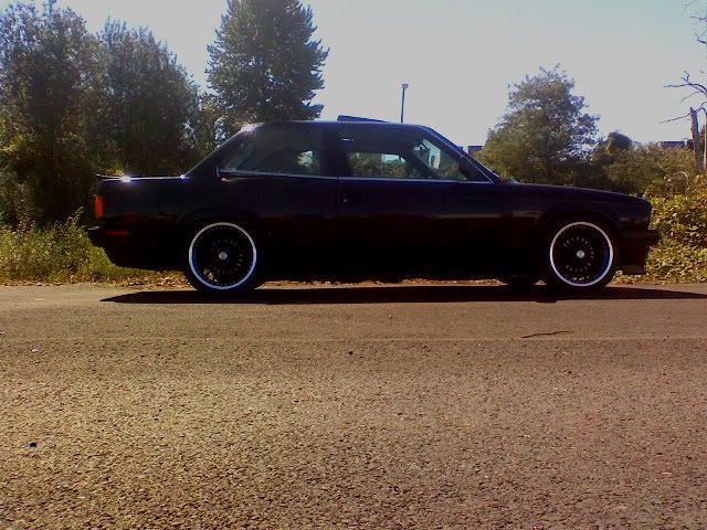

                              H&R race, bilstein sports, super thin pads on the front, standard on rears. 17" wheels. all new suspension bits.
                              no reverse rake here.
