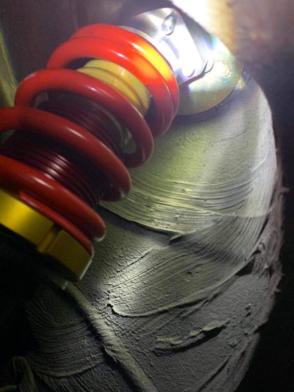

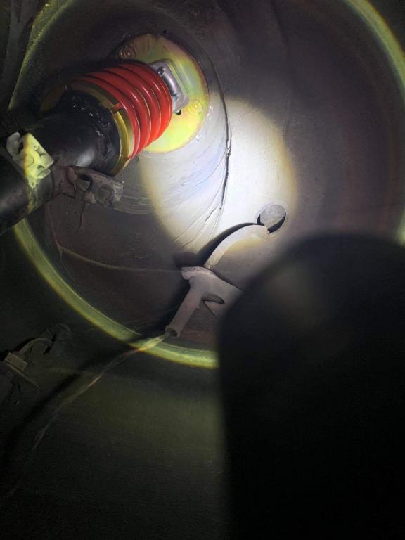

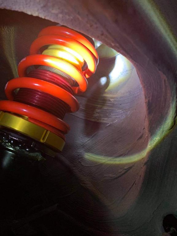

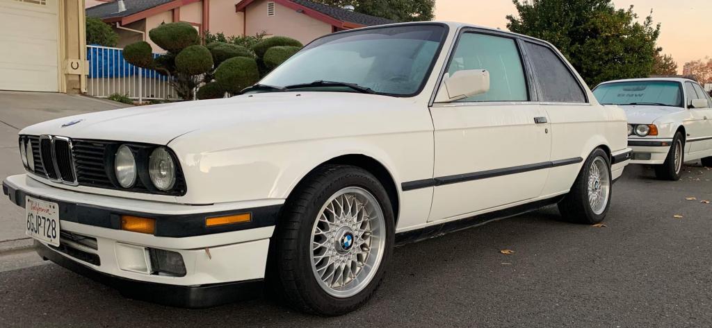

    We decided to go with the Ground Control Coilover Conversion Kit + GC standard Koni adjustables. And while happy with our purchase for the most part, we found that the front is sitting a little high (for our tastes) despite being at the maxed out low setting. We've already cut the spring perch per GC's instructions.
    After a bunch of research I know that a lot of people just shorten the strut housing. But we just purchased these Koni Strut Inserts and my dad likes how they ride, so we're looking for another way to get a bit more drop without shortening the struts this having to buy new shorter iX inserts.
    I found some old threads on here where some owners sourced 5" inch springs to put up front and get more drop? Where can I purchase these? GC's website only lists 6" inch springs as the lowest, and that's what we currently have on. Also does trimming/removing the bump stop allow for more drop maybe? I also something about trimming the adjustment sleeve to make it more flush with the top of the strut? These are all potential solutions that I've read about on older threads on R3V but would like a little more detail, if possible...
    Below I've provided some pics of exactly what we're working with:
    Click image for larger version  Name:	IMG_8916.JPG Views:	6 Size:	44.0 KB ID:	9964327 Click image for larger version  Name:	IMG_8915.JPG Views:	5 Size:	35.4 KB ID:	9964328 Click image for larger version  Name:	IMG_8917.JPG Views:	5 Size:	58.0 KB ID:	9964329

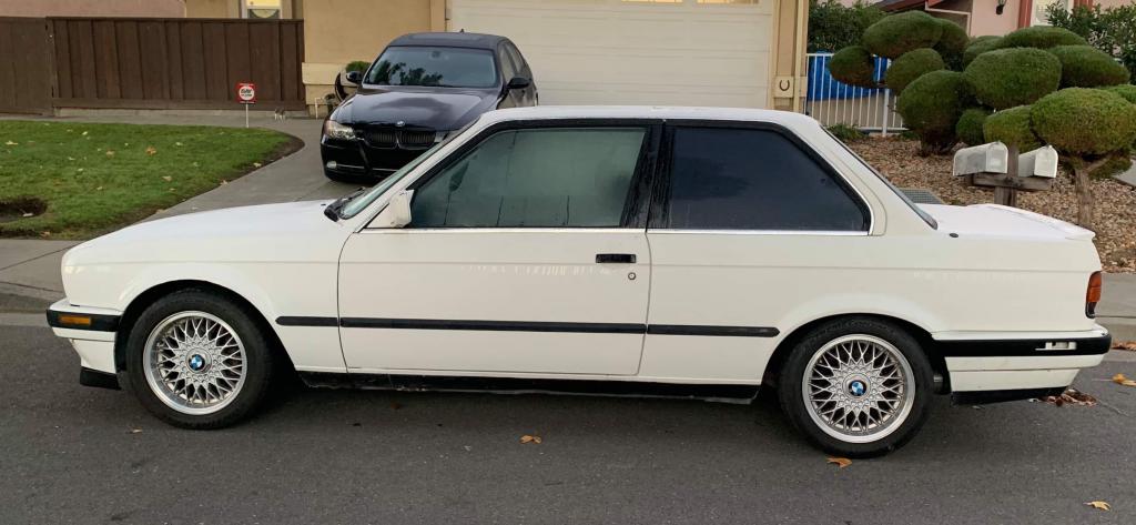

    Im no help but whats it look like from a profile pic of the car?
    Im thinking about GC coils as wel.
    • Esanju
      • Dec 2020
      • 8
      Just edited some pics in the OP. As you can see, a lot of front gap still.

        You can either go with camber plates that have a thinner stack height and/or 5" coils up front. Cheapest thing to do is remove the adjuster so that the spring rests on the bottom perch but of course you lose your adjustability. You can do this in combination with a 5" spring if you want to go even lower without having to replace the camber plates. All depends on how much lower you want to go.

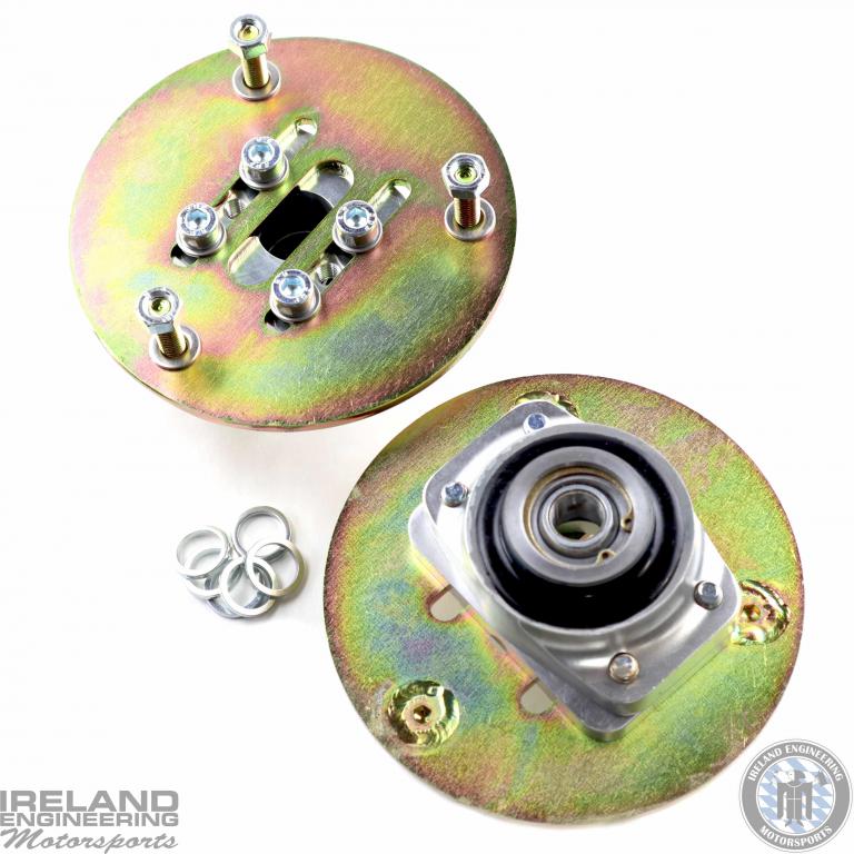

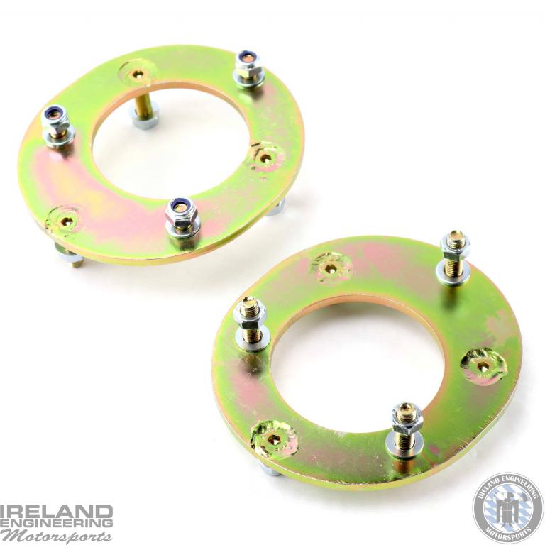

              And yeah, I think I made a mistake with the camber plates. I'm running these:
              Is it safe to say that these would have a lower stack height?

                        It hasn't been stated here but keep in mind, late model e30s, for sure all stock with plastic bumpers have a lower arch in the rear. This will always give the appearance that the lower sits more tuck and front has a gap. You can lower it more but keep in mind the rake in case you want to deal with suspension geometry.
