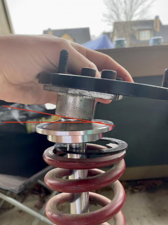

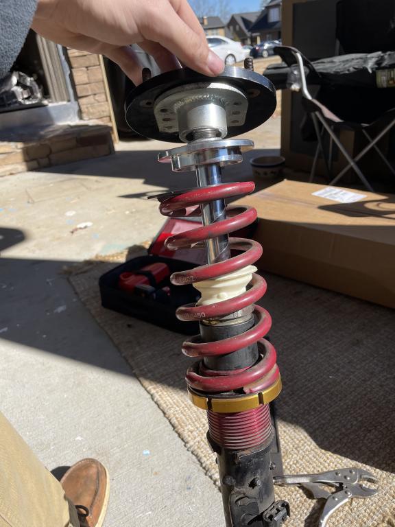

    So i'm in the middle of building some custom coilovers using GC adjusters, MR2 rear struts, custom top hats and IE spec camber plates. I'm having an issue with the spacing between the camber plate and top hat as well as an issue with threading the nut on all the way.
    Does anyone know how much articulation there is in the camber plates/strut mounts compared to the spring top hat?
    Currently it can move about 10 degrees relative to the spring top hat and I am concerned with contact being made between the top hat and camber plate.

    Here are some pictures
    • cdl723
      • Jan 2015
      • 144

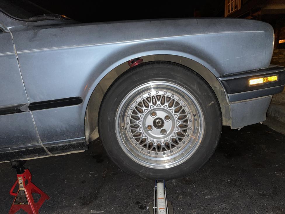

      I ended up tapering the washer a little and this allowed me to get roughly 9-10 degrees of angle. It appears that it will work when installed on the car with the camber maxed out and a lot of caster. I jacked the wheel up and it does not appear to bind yet.

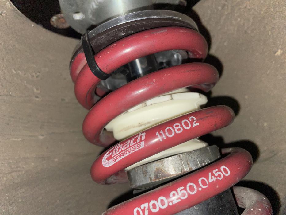

              This set up drives pretty well, but I think it is hitting the bump stops over high speed bumps. I need to do the zip tie trick to measure the damper travel and verify this.
              • cdl723
                • Jan 2015
                • 144

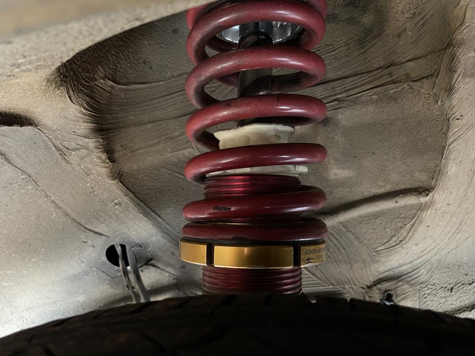

                I decided to pull the struts and cut them around 1.5" out, so I did not need a spacer. It feels as though it rides a little better and there is no longer a harshness associated with medium/large bumps. The first picture is with strut tube spacers and the second is with the tubes cut and lowered another 0.25" from before.
