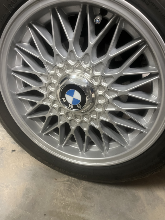

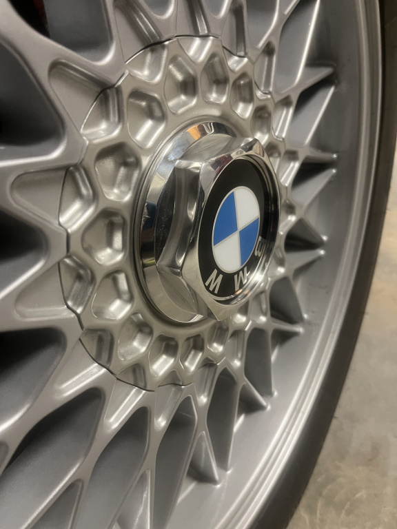

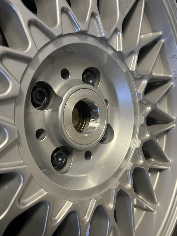

                  Welp maxilite sent me 2 new caps . I didn’t like the idea of losing caps again so with ehrlich wheels works hex conversion for euro weaves they work perfectly on the maxilite . Threaded insert for the hub and polished hex . I reused the maxilite aluminum waffles . 300$ but piece of mind for me is worth it . Will probably powder coat the hexes later
