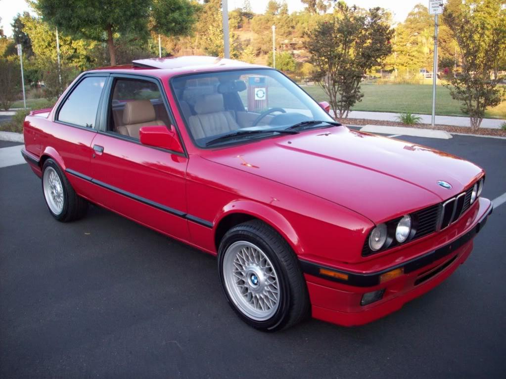

    For others (preferably with lowered suspension) who are running re-drilled E38 Style 5's, what tire size are you running? or for wheel/tire guys in the section what would be a good choice for these wheels considering they are ET23 and require a 5mm spacer upfront. I found, In my opinion, a lot of picture made them look too pushed out from the body upfront, which I know there isn't much you can do about when they are 16x8 et 23 and require a 5mm spacer. I've attached a photo of what I mean, and the shown car is said to have no spacer up front and 205/50/16 rubber. Although it is not lowered I feel it pokes out of the fender/off the body too much up front, for the look I am going for. I was thinking of going 205/45/16 to try to keep them not so "poked" up front (and because I don't mind a little stretch look if that will occur). Otherwise I was thinking 215/40/16's in hopes of a normal finish, not too wide up front, and not showing too much tire profile but filling the fenders (Maybe using a small spacer in the rear as well. Any good input or opinion is appreciated.

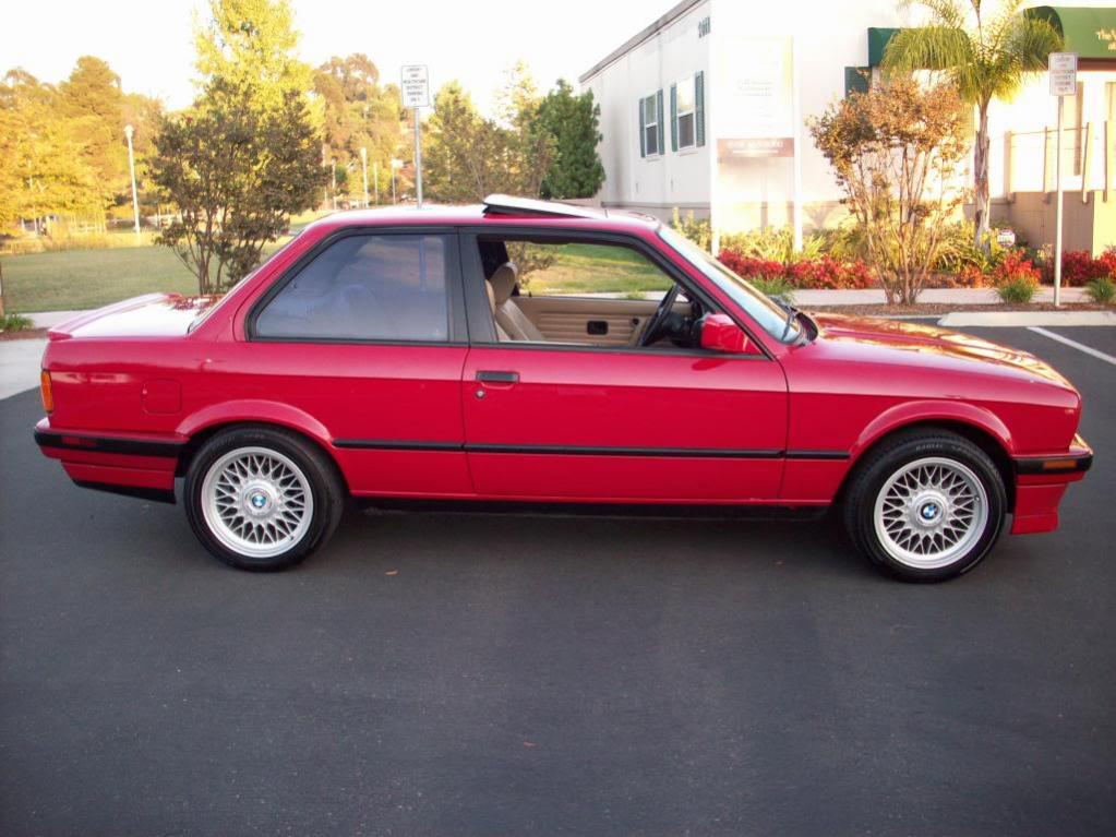

      205 45 16
      getting new ones soon... same size

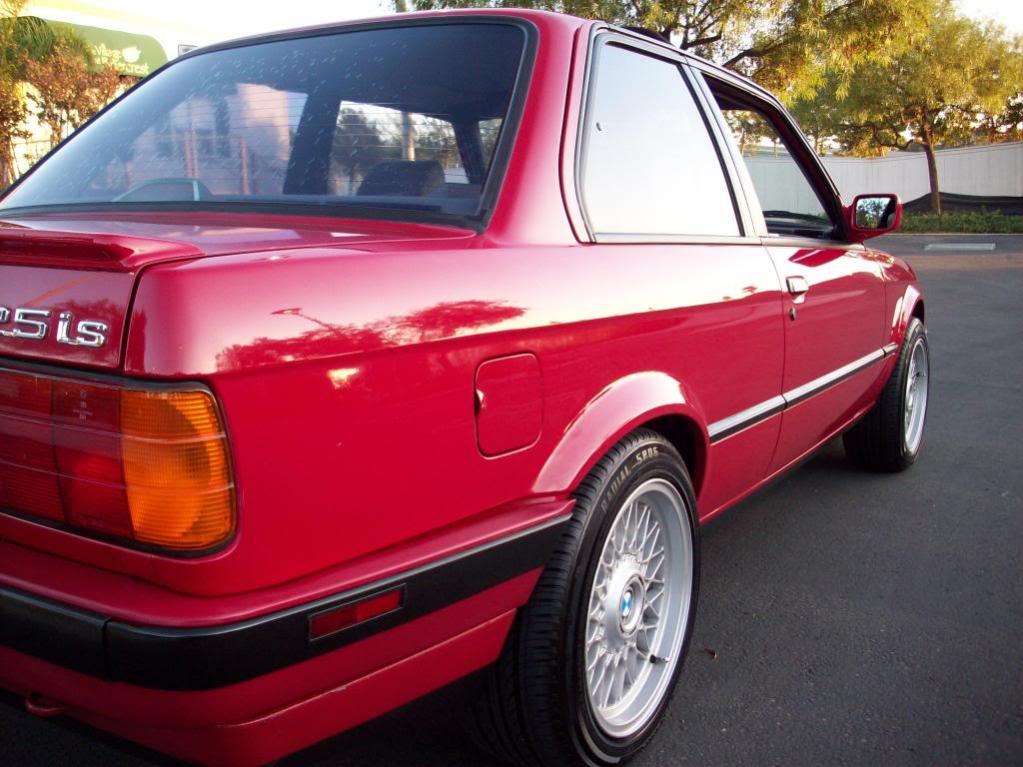

              pic w/o spacers:
              1991 325iS turbo
