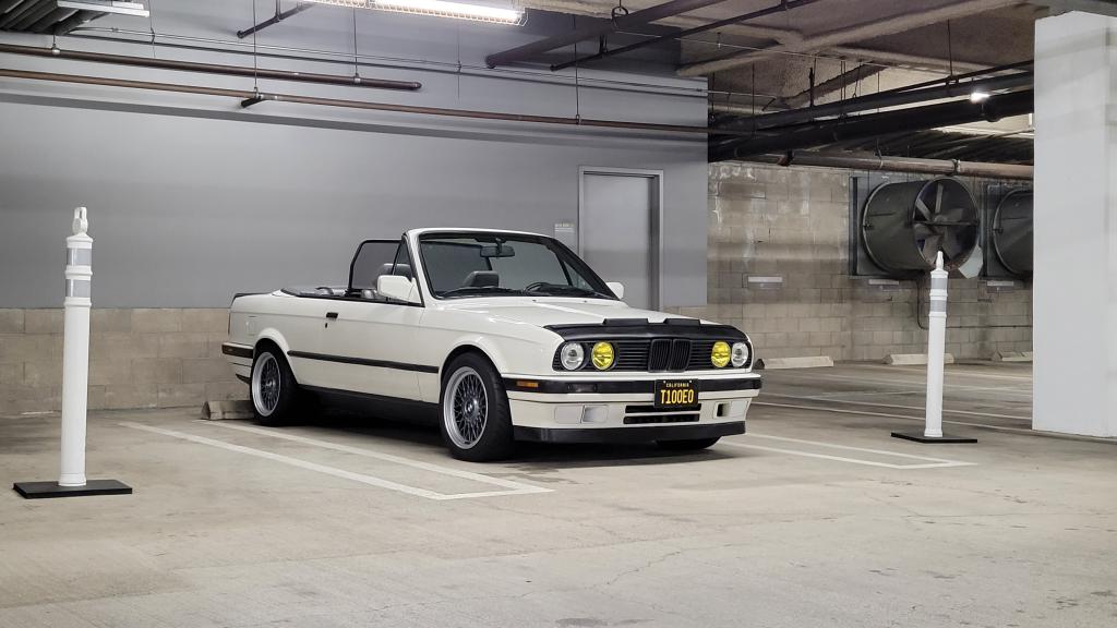

                          225/45/16 with 8mm spacers up front and 5mm spacers rear.
