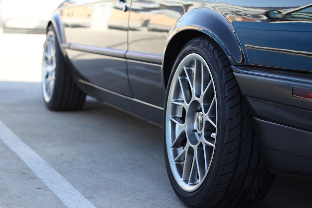

                            I have the 215/40 S-Drives on my ARC-8s, and they fit very well.
                            Federals are garbage, stay away from them. They only look wider because of that retardedly huge lip/bead protector they have. The contact patch of them is A LOT narrower than the S-Drives side-by-side.

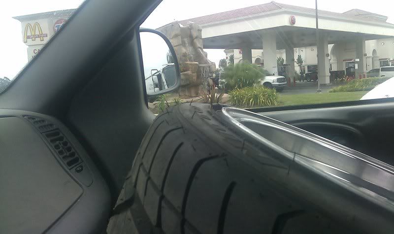

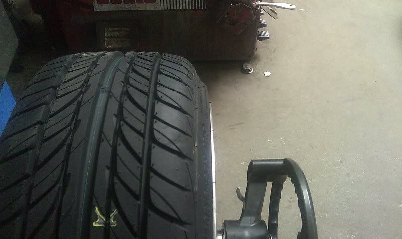

                              Yeah Josh, they fit well. I was just comparing them to say falken 512s which run SUPER narrow. So in terms of sizing, they are pretty close to true sized. The NeoGens however run much wider.
                              for example:
                              205/40 Falken 512 on an 8" wide wheel
                              205/40 Nitto NeoGen on the same 8" wide wheel
